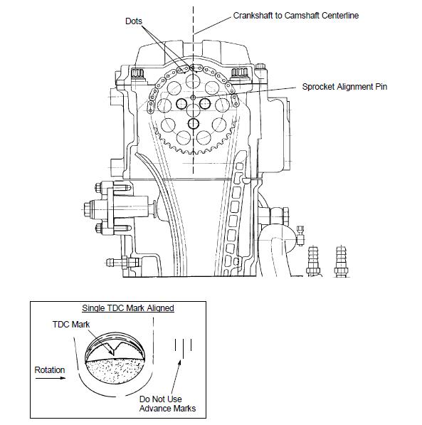

Start at the basics and if you haven't cleaned/rebuilt the carb,eliminate it as the problem along with having a good clean air filter.You can also pull the fuel line from the carb,crank the engine over and you should have a good flow of fuel. Make sure you have the stator plate timed to the case mark. If none of this helps you may want to remove the tensioner, stator plate and reset the cam timing. The lower crank sprocket marks aligns with the case mark on the bottom.This is tdc. Have the cam sprocket index pin dead center of the head and reposition it on the cam. Reinstall the tensioner,set the valves,install the recoil and pull over slowly so the tensioner adjusts slack on the cam chain.
Attached Thumbnails 96 polaris 500-2011-05-21_125845_00_polaris_500_cam_timing.jpg

Ok, Thank you, I get most of it, except for, "The lower crank sprocket marks aligns with the case mark on the bottom". I think this refers to the smaller of the two pics you sent. Exactly where do I look for this mark, I dont recognise the drawing, and whats the best way to clean the carb? I have a new air filter, the fuel flow is good, and I have a new spark plug. Thanks again.
Old Sep 25, 2013 | 02:25 PM
This is just a generic pic on cam timing.The lower crank sprocket is behind the recoil,flywheel and stator plate. If you've gotten the cam timing off, by moving the timing chain,this is the only way for sure to get it back in time.
