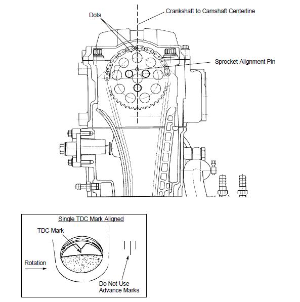

May have gotten the cam timing off.
Attached Thumbnails 2002 sportsman 500 bogging down-2011-05-21_125845_00_polaris_500_cam_timing.jpg
