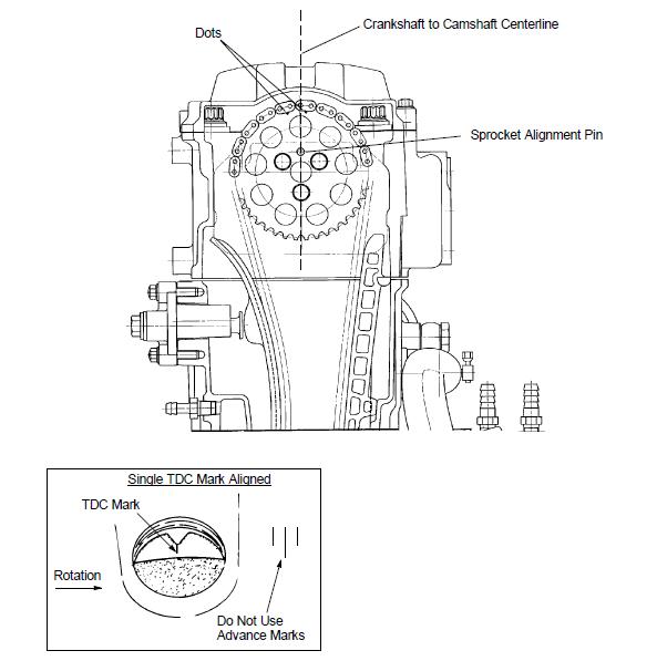

Yes pull the limiter wire first. You can leave it unplugged as all the limiters would fail. Once you get it running right you don't have to push the over ride button in reverse to have full power. Checking valves and cam isn't that tough. Pull the valve cover and spark plug. Pull the recoil over slowly and watch the INTAKE rocker arm go down and start to come back up. When the cam sprocket alignment pin is dead center of the head you're at tdc. The two valves can be checked/adjusted then. You can tell for sure if the cam lobe is ground down,but not many reports on this happening. Different cam than used in the others obviously with only the 2 valve system but no harm in checking. Compression test on these are similar to the 500 since it has a compression device on the cam end. Around 45-50 psi on average. Plus here's the pics on how the cam sprocket alignment pin looks at tdc.The 335 uses the same sprocket part number as the 425 and 500 engines. Also you may want to check the compression release spring. If it's broken they'll run like crap also.
Attached Thumbnails 2001 sportsman 500 ho runs rough-2011-05-21_125845_00_polaris_500_cam_timing.jpg   2001 sportsman 500 ho runs rough-ff1tv7.jpg
