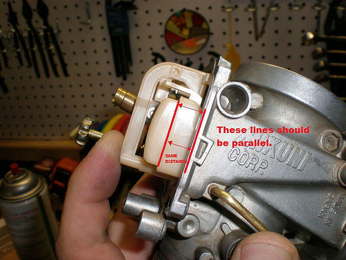

Even though it's a 2001 HO 500,I'd check valve clearance first and the exhaust lobe for any wear. .006 intake and exhaust on valve clearance. If that checks out,may be as simple as the float sticking,worn needle and seat. If you have to pull the carb,I'd install a cheap carb kit as cleaning doesn't always help. Polaris Sportsman 500 2001 2002 Carburetor Carb Rebuild Kit Repair | eBay The floats are tricky on this model. Needs to be set where the float tab barely touches the float needle pin with out compressing it. This is how it's supposed to set.Plus here's another version of the BST40 carb that may help.http://www.advrider.com/forums/showthread.php?t=347184

Again if you smell fuel,probably the float level allowing too much fuel even with the new carb kit.A lot of people had problems on these along with fuel dripping from the over flow tube. Keep us updated.
