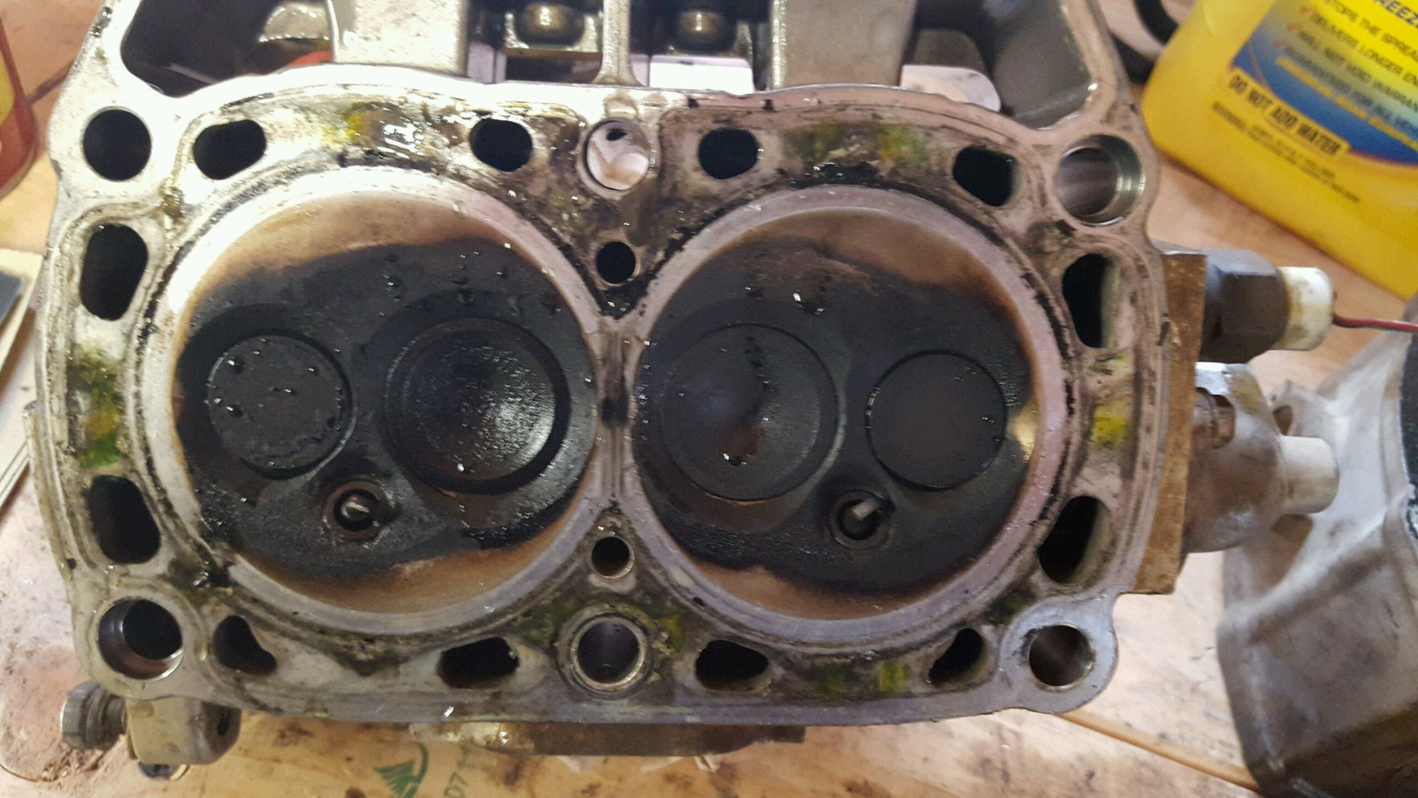

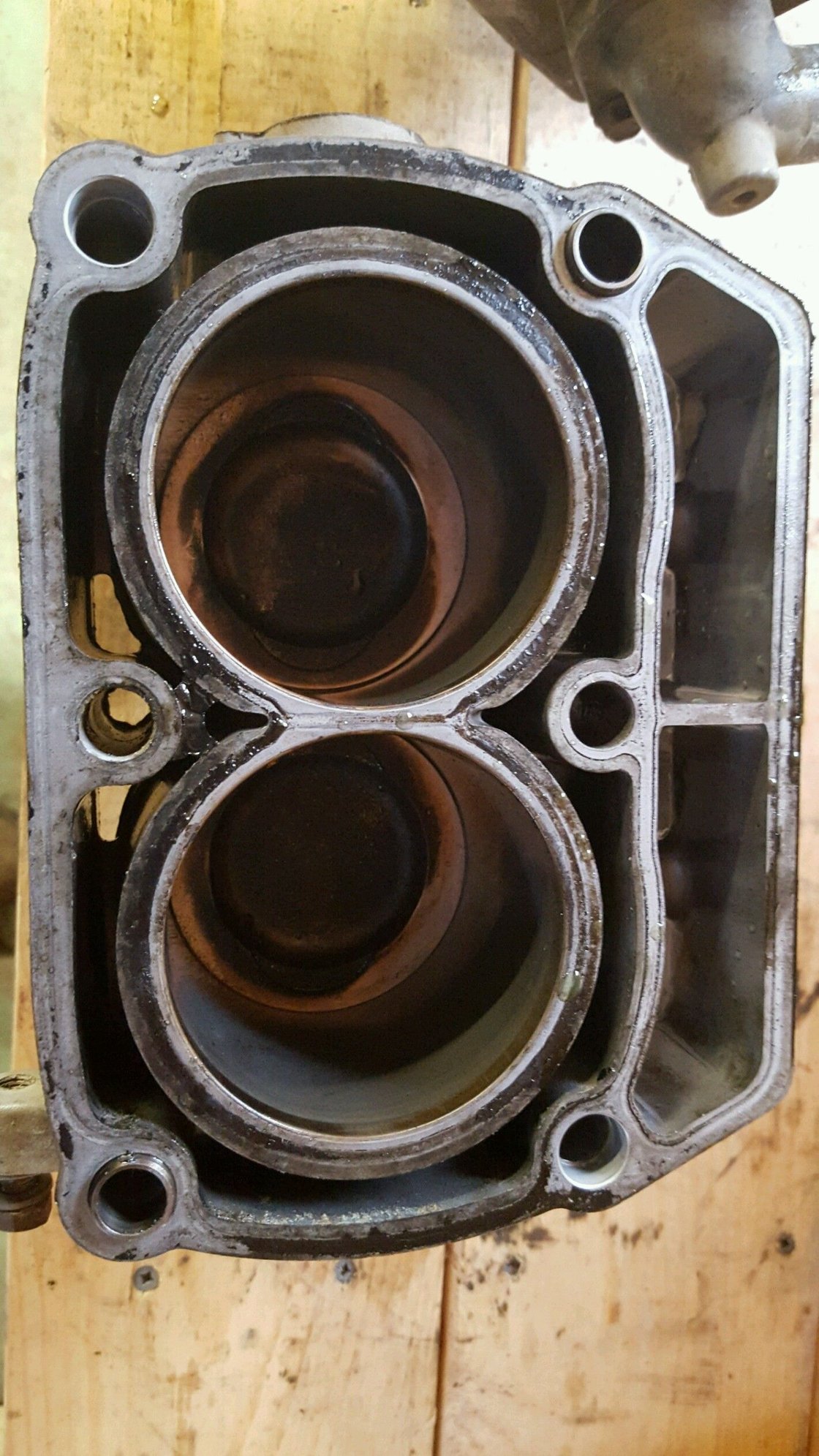

I got this all tore down, valve cover had lots of antifreeze residue in it, as do the lifter area. Head bolts were not very tight at all. Rocker arm bolts were twice as tight as the head bolts.
Its not obvious if either head or base gasket was leaking. They appear intact and I cant see where the antifreeze would have been going through.
Iv read in another thread about the water pump or oil seal could cause an issue, but regardless the head bolts were defiantly not at the proper torque.
Lastly there are a bunch of fins on the radiator that need straightened. Maybe it over heated? I dont know.
Any thoughts?
