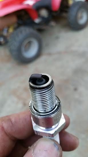

Got the sensor and it fixed the fan!! Can you help me with one more thing?.... Does moving the carb needle clip up ritchen up the mix? I cant seem to get the "perfect color" on the plug according to the pics I look at. Here is the plug chop on a new plug

Moving the clip up leans the low to mid range mixture as the needle goes deeper into the needle jet.Dropping the clip(raises the needle) which richens the low to mid range mixture. 2nd to 3rd position from the top is the average positions for most. Imo all the Scrambler 400s were jetted too rich to begin with on the main jets because Polaris knew most would be abused,run wide open,but tough on low to mid range running on a lot of machines. They had a stock 230 main to where the Explorer 400(same engine) used a 200 main jet.You might consider dropping the main to a 220 and see if helps also if needle position adjustment doesn't help. Plug is a tad on the rich side. Should be a tan to medium brown. Also if carb parts are worn(needle and seat worn,float arm adjustment off) it can run rich also. On any major jetting changes just plug chop again.
