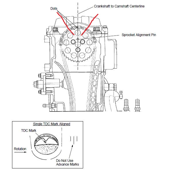

took it back apart, chain seems good BUT
when i go to put it TDC, the motor seems like it doesnt want to line right up, like its going over a lobe in the middle of it, my sprocket doesnt line up..heres a pic of where it "rests" when i have the flywheel in a very close ballpark of TDC..its either here or there, never feels like i can get it right on, like its off a tooth maybe, i had it lined up last time i was in there..i thought..(trying to get more input before i take the flywheel off and re time it...could/can it run like this since i did a head gasket last year???

If the bendix has a weak spin out and return,just replace it as cheap as they are.. On the cam timing look at this guys pics as a refresher. If you can't line the plated links up with the lower crank sprocket and case mark and the two dots on the cam sprocket correctly,then might be time for a new cam chain.https://atvconnection.com/forums/pol...ml#post3305250

chain feels good and last time i did a head gasket, it all lined up...is it possible that it still runs great in between click clacks with it being out of time??

Is Plus have you checked to see if the slotted nut at the lower crank sprocket might have backed off and grinding up against the back of the stator plate? This noise can radiate upward and can confuse you as to where it's coming from..
exactly right on, sucker is just spinning freely...ty opt! i was about to just put the new bendix in and call it but i knew the timing was off....
so im thinking the nut backed as far as it could go and the lower spocket moved over enough to skip up the timing?????is that plausible?? if not then i may have to get even deeper....
