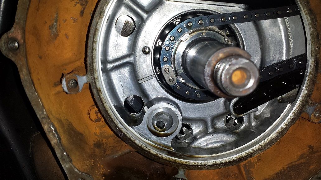

Attached Thumbnails need some opt knowledge!-20151028_185153_440eb6165fcb163313986c5b8761342e4ad20e90.jpg

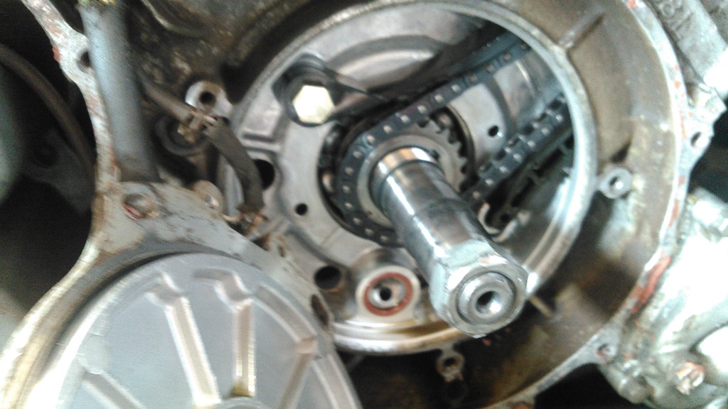

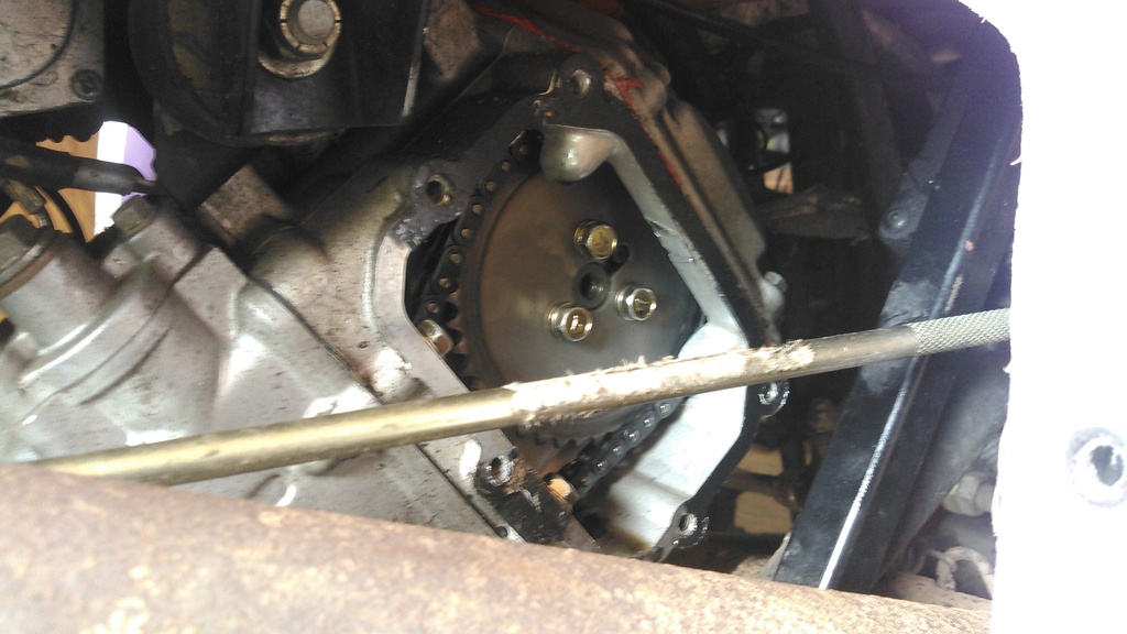

so after a good head scratch i took a look and am determining that it actually indeed IS in time....i was under the assumption the key was supposed to be at 12 o clock if you look straight at it...its more like 2 o clock lined right up with the cylinder...looks timed to me? marks line up, cam looks right..right?
Old Jul 22, 2016 | 11:54 AM
  #30
Just turn your head to the right and everything will look straight to you.. Yes the engine is at an angle,the key slot also. Main thing key and sprocket looks ok,lower timing mark is on the money and the cam sprocket alignment pin is center of the head. Again you have to turn your head for it to look right. Loctite the shaft threads,install the slotted nut then the stator plate, flywheel,recoil cover and see how it does.
