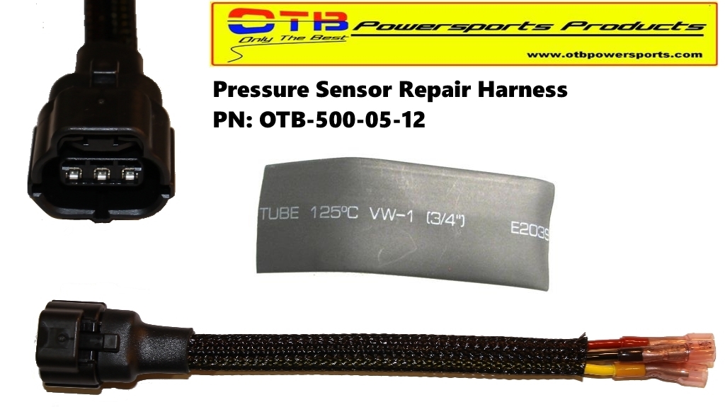

Ok thank you for the help. I ordered new harness connections. Hopefully that will fix it. Do you just cut the old connector off and splice in the new one?
Old Sep 25, 2016 | 06:14 PM
  #16
New connector just plugs in the sensor. You cut the old wiring harness to the length of the new wiring,has connectors and shrink wrap for a good tight fit.
