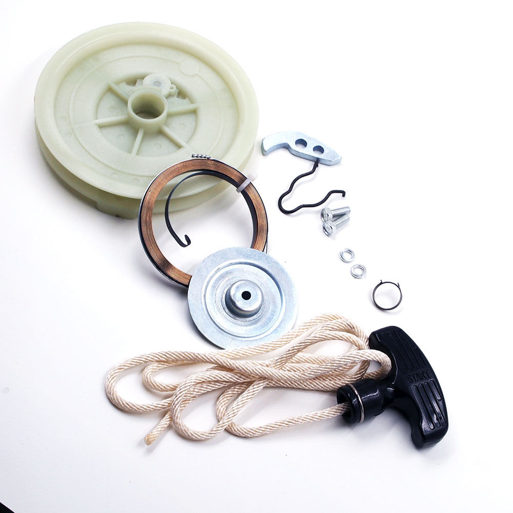

Well my recoil is broken so i will order new parts for the and a new pick up coil and when I do that I will put the new stator, pickup coil, gasket, and fix the coil... idk what to do lol I will update afterwards. One more question though, the plastic recoil keeps on breaking where the metal dog goes... seems like there is so much compression it breaks it... is it just a bad design?
Old Oct 13, 2016 | 07:10 PM
  #30
Recoils are not usually a problem. Rather than buying one piece at a time recoils kits are on ebay.
