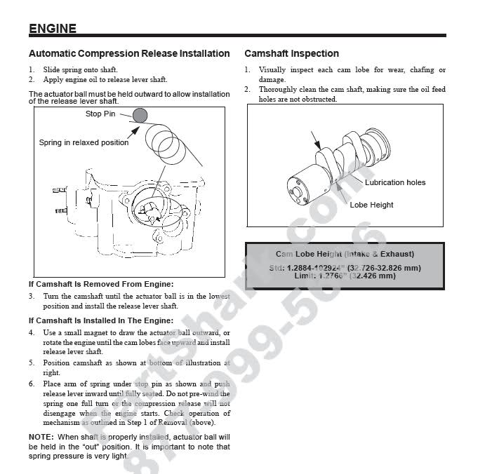

If you're going through that much trouble replace the whole blamed thing with an after market one and see how it does.New Polaris Complete Recoil Starter Pull Start Assembly Sportsman 500 1996 2011 | eBay Recoils shouldn't be breaking like this. May not hurt to recheck the spring on the compression release assembly.
