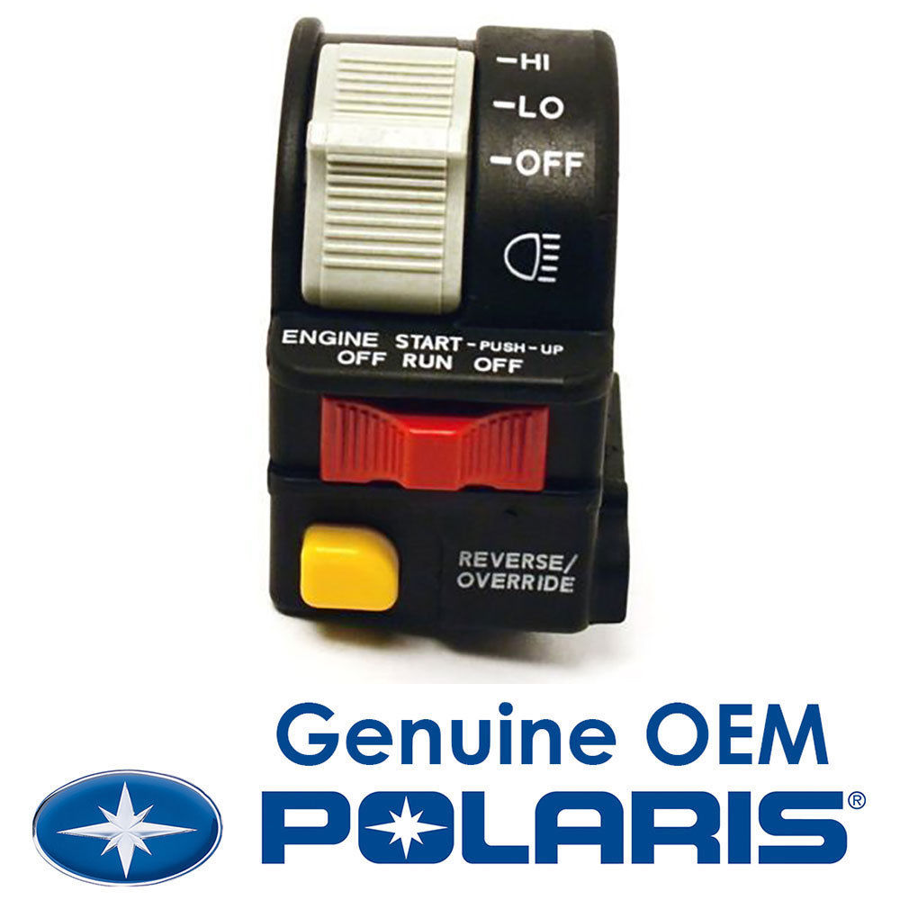

Check the wiring from the control switch down into the harness for any bare wires. If this checks out and spraying electrical cleaner doesn't help,then if you're so inclined,you can tear into this switch. This 3 position switch,on/off,up to start was one of worst ones that Polaris came out with for failing.Possible if you can get it apart without loosing parts it may just need contacts cleaned to get it to work.

BTW - this is the capacitor I'm talking about. I'm guessing this is the part that is burnt out.

BTW - this is the part that I think is bad - the capacitor.
Inside of switch

The parts you're looking at in your picture are a resistor and diode in series , appear to be for anti feedback to the lighting circuit , the resistor { the part with the colored bands } should read around 470 ohms and the diode { the black thingamajig with one band on it } should read continuity one way and infinite reading the other way with your meter set to X1 scale . I doubt either of those components are your problem

Thank you @Yooper265, exactly what I wanted to find out. I tried cleaning the switch contacts, no luck. Looks like I'll have to replace the switch. Nothing else I can do to make the old one work.

That's what a lot of people had to do.Usually the brass plates corrode and once you take apart down to the switch,almost impossible to get it back together right.I remember trying to tear apart a switch on an old 94 model and it ended up in the trash..Replaced it with a new one.
