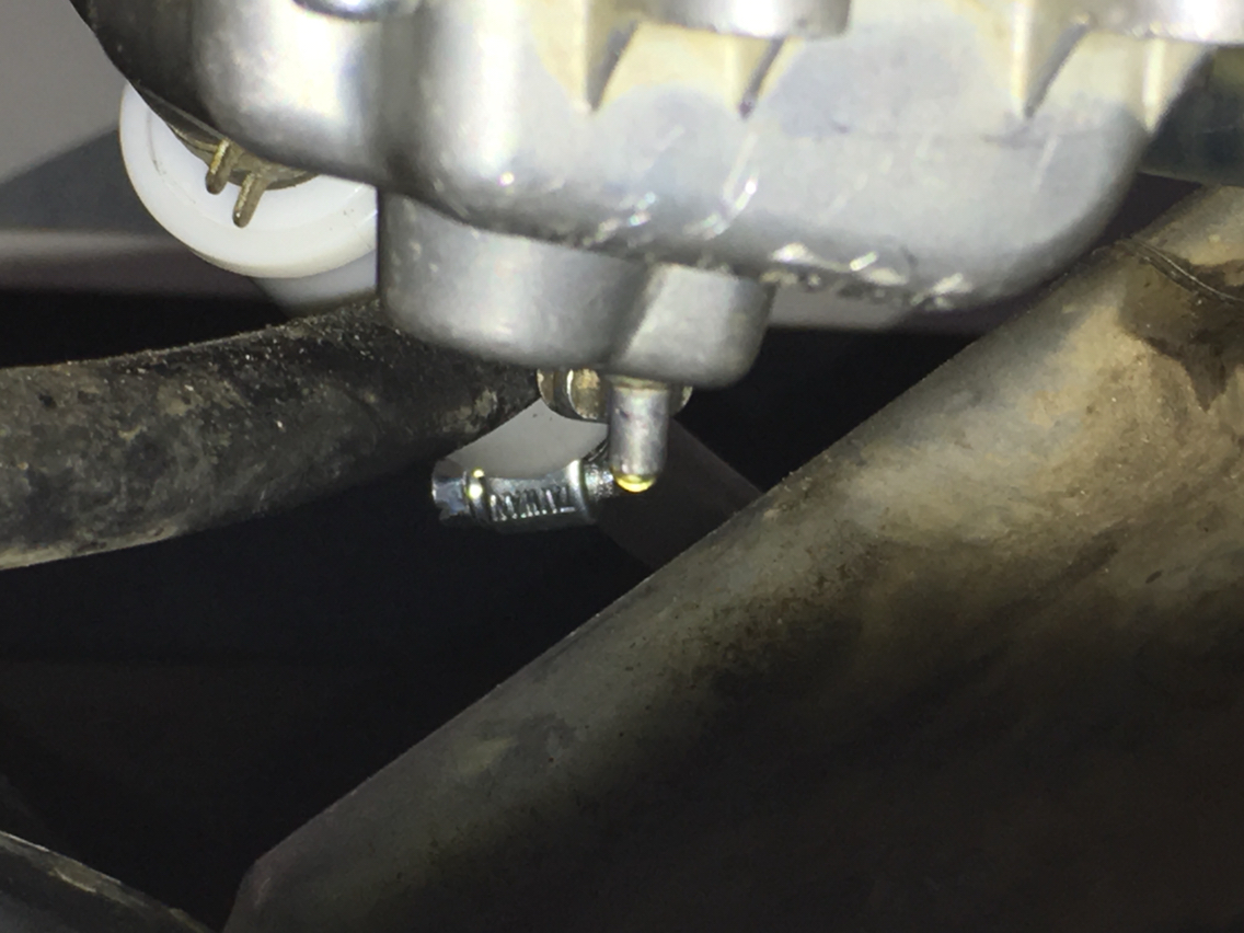

This is my carb float overflow. It doesn't drop, but I see a drop hanging.

Compression should be between 55-90 psi on average because of the compression release device. Even if you show between this amount still could be leakage from valves or rings causing plugs to oil up This is where a leak down test can tell.Plus if the carb is dripping,sounds like the float level is off.

I can adjust the float. But I'm guessing I'll have to go to a garage to get a leak down test and a compression test?
