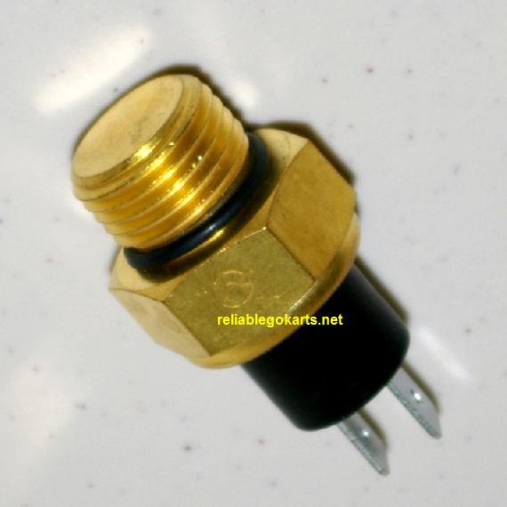

Thanks OPT, I thought I had read that on some of the previous boards. I have an additional question, My fan does not come on very often, I know not the usual problem, it does come on but not very often. I am not a fast or mudder just a slow trail rider, I was wondering if a lower range contact would be in order or leave well enough alone? Thanks in advance.
Old Feb 8, 2017 | 01:34 PM
First thing is to make sure the radiator is clean font to rear.It may look clean but dirt can pack up at the rear. Second thing is to replace the temp sensor on the radiator. Simple two pronged sensor that's nla through Polaris but you can match them up at most auto stores.Last could be the old motor may be getting weak. Replacement motors are high $ but on ebay they show Spal type fans that can replace these old style motors with the metal blades if needed.

Thanks I will check the rad to make sure clean. Should I go to a lower rated sensor or stay with the same
Old Feb 9, 2017 | 08:54 AM
Try to stay with the same rating if you can.Wouldn't hurt though if a replacement is a tad lower temp to trigger the fan. If the fan doesn't trigger any faster then you may need to look for a fan replacement.

Got the new hoses on. I could not route them back to the original was due to stiffness. I had to run one over top the exhaust to the front. Any ideas to put over this one hose close to the exhaust? I was thinking maybe metal tape or I have some exhaust wrap left maybe put that over the rubber hose or do you think it would keep the heat in? The fan never came on or the hot light once I filled the rad up. I will check the temp trigger and most likely get a new one. Ran it hard for 20 minutes or so no leaks, no hot light and no fan.
Old Feb 17, 2017 | 06:52 PM
Use the heat wrap on that one hose. If you have heat problems with this hose,you can always install the oem preformed hose you have,repair it like I showed earlier if you find a leak on it.Oem hoses are expensive,some you can't get anymore,but can be repaired if need be. Hopefully the sensor solves the fan problem,plus you can always run 12 volts to the fan to make sure it's operating properly also.
