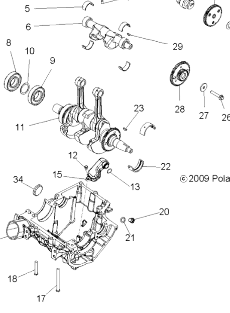

how to dissembly piston arm from crankshaft gear?It possible to dissembly piston arm from crankshaft gear on this model or have to buy a complete crankshaft gear because one piston arm worn out need replacement.
please help any one I'm from Africa no Polaris dealer nearby me I'm stack.[img]webkit-fake-url://1757ca40-eeb5-4bdf-8b1b-ac3235afa758/imagepng[/img]

Rods are pressed on and sold as a crank assembly.If you have places there that can rebuild crank shafts like we have here,that might be the cheaper way to go. If not then the crank is sold as one piece.
