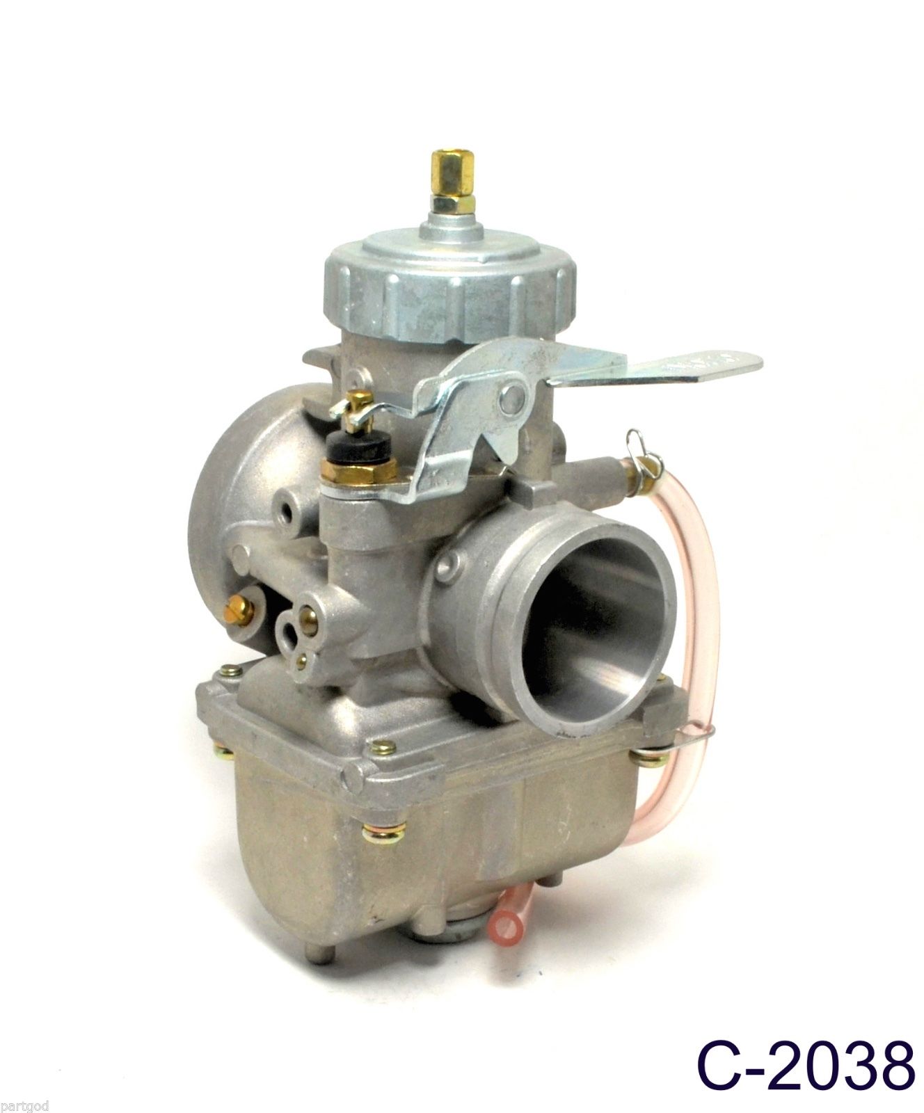

You can find these after market carbs for 35 bucks if it's a 2 stroke carb. 4 stroke carbs aren't too much more. You can remove the manual choke and use your cable operated one in it's place.

Yea it's a 2 stroke. Any idea where? I haven't seen one that cheap!
Old Mar 26, 2017 | 09:16 AM
Carburetor 34mm intake Round Slide Carb Carburetor For ATV Dirt bike snowmobile | eBay
