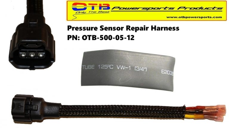

Codes may or may not be thrown,but usually back firing ,erratic idle is cause by either the tps or tbab connector or wiring,not the sensors themselves. Even the service manuals say 85% of efi problems are wiring or connector related. Polaris makes crappy harness repair kits.. I replaced enough to know that they wouldn't last and I had to repair some machines more than once. Look at the sticky post above this section on 700/800 efi problems.Includes all efi models. This led to a member making better repair kits. You can sometimes find the faulty one(usually the the tbap) by wiggling the harness or inspection the harness for chaffed or soft feeling wires that have melted internally. Connector pins can pull out also. The one pictured is probably the one causing all the problems.Here's the site. https://otbpowersports.com/products/
