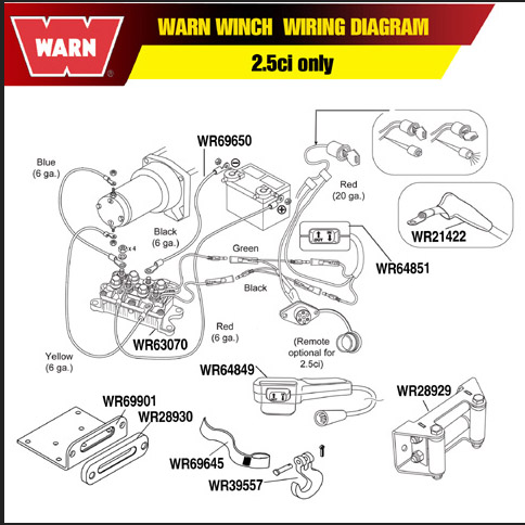

You lost me opt. I need to connect a switch control wire to the ignition switch to both run and battery on to control the winch so I don't have to turn the quad on all the time.

The small red/white wire is only for the switch control. You should have a commutator or solenoid of some sort that is the main power for the winch motor and cables hook to the battery.

No solenoid but a relay that controls forward reverse and what not to the winch. The control switch mounted on the handle bar needs a power when the key is turned to on or run. They say to use a circuit tester to find a wire that has power when the ignition switch is turned to on and run. So I was asking without having to test all the wires which wire to hook up to.

Like I mentioned ANY red/white wire is only powered up when the key is turned on. You should have a spare one in the main harness or simply tap into any red/white.
