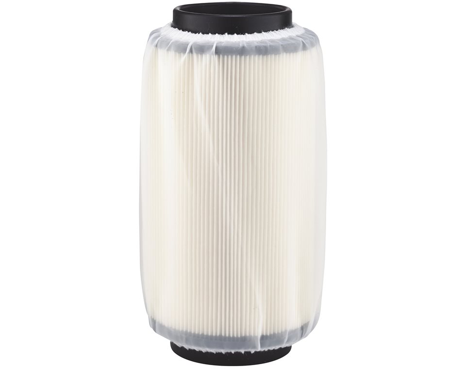

If I'm not mistaken it came with a paper filter with a stocking-type pre-filter. I think all 4-stroke Scramblers and Sportmans ever made use the same filter including the new ones. Why would you oil a paper filter? If mine gets oily I throw it away and buy a new one.

Some models of the Scrambler 400 had foam precleaners over the paper filters that you could oil which were really needed for these engines. 500s just had the fine mesh prefilter.

I know the 2-strokes had their own thing going on, but other than those, all the Scramblers and Sportsmans I've ever seen had a paper filter with a "sock" on them, like this pre-filter from Polaris' site. "This Pre-Filter fits securely over the air filter to enhance its performance and extend the life. Water repellent and can be cleaned multiple times." I've seen a black one at least once, but don't know if it was OEM or aftermarket. It looked like a generic Outerwears with no name on it.

What's strange is that first 96 Sportsman 500 and the first 99 Ranger 500 used gray foam prefilters.After that they went to the mesh.https://www.ebay.com/itm/Polaris-96-...Jaz3aO&vxp=mtr

I've seen foam pre-filters like that on other brands of ATVs too. My first ATV was a '97 Sportsman 500 and the filter looked just like the new ones, except the plastic on the back end changed color sometime over the years. Without looking at one, I think the new ones are blue and the old ones were black. The mesh must be better than foam somehow, or just cheaper. When I think of foam filters, lawn mowers are the first thing that comes to mind.
