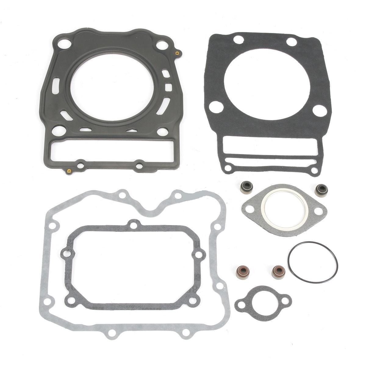

Can you show me what a head gasket looks like?
Old Apr 27, 2018 | 01:42 AM
You ca get an oem head gasket or an aftermarket top end gasket kit. Head gasket to the left,base gasket to the right if you have to remove the cylinder.
Attached Thumbnails 2000 Polaris xpedition 425-kgrhqn-p0fbg6dmwlibqgyu6vklw-60_57.jpg
