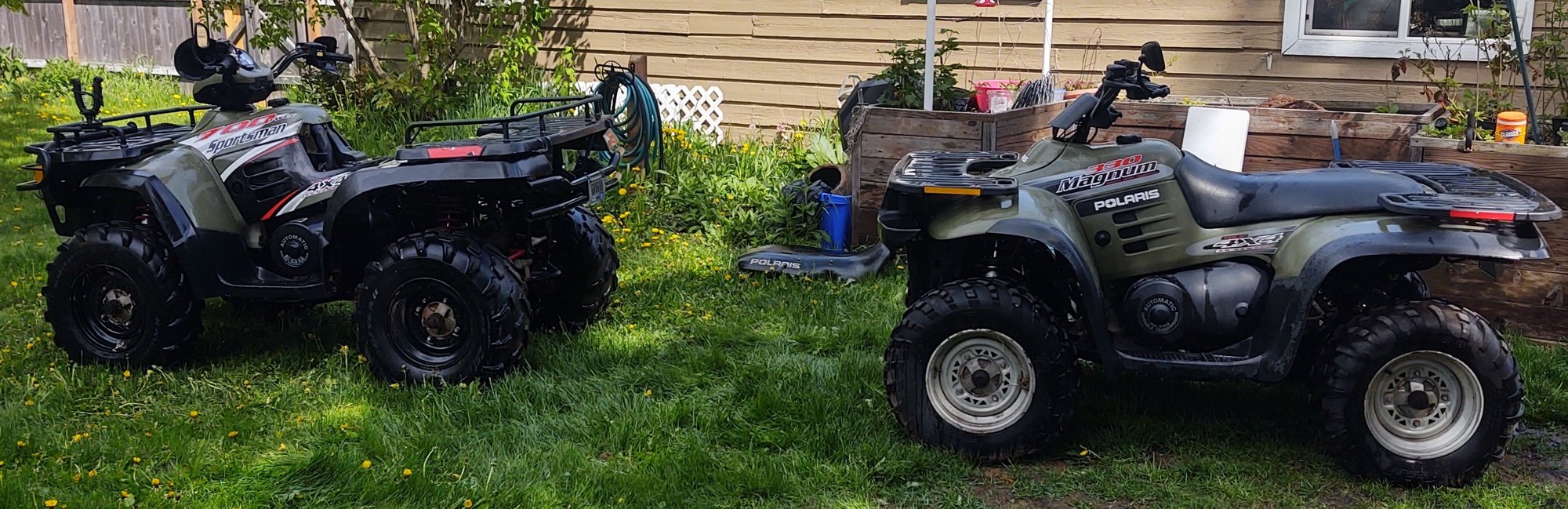

Im the type that depending on the rest of the machine was decent and usable i would dump some cash into it but i like the older stuff myself as long as parts are not an issue.
My current ride is a 2004 700 that sat for years with a bad clutch. Last licensed in 2008 and was pretty much gave to me as long as i bought the other one for 1K.
