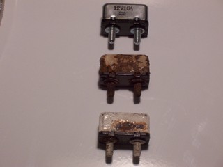

OPT do uno if there an circuit breaker between batt and fuse box? I have no power to fuse box....Load test batt and did an leak down test on batt its fine...
Old Mar 17, 2016 | 08:50 AM
20 amp circuit breaker on the harness leading to the fuse box. Should be power on each side of the red wires leading in and out of the sealed pouch. If not,slice the pouch open and check the terminals. May be corroded or blown. Can get these at any auto supply for a few bucks.Item #6 on the break down. Dirt Cheap Yamaha, Polaris, Suzuki & Kawasaki OEM Parts & Accessories – Cycle Parts Warehouse
