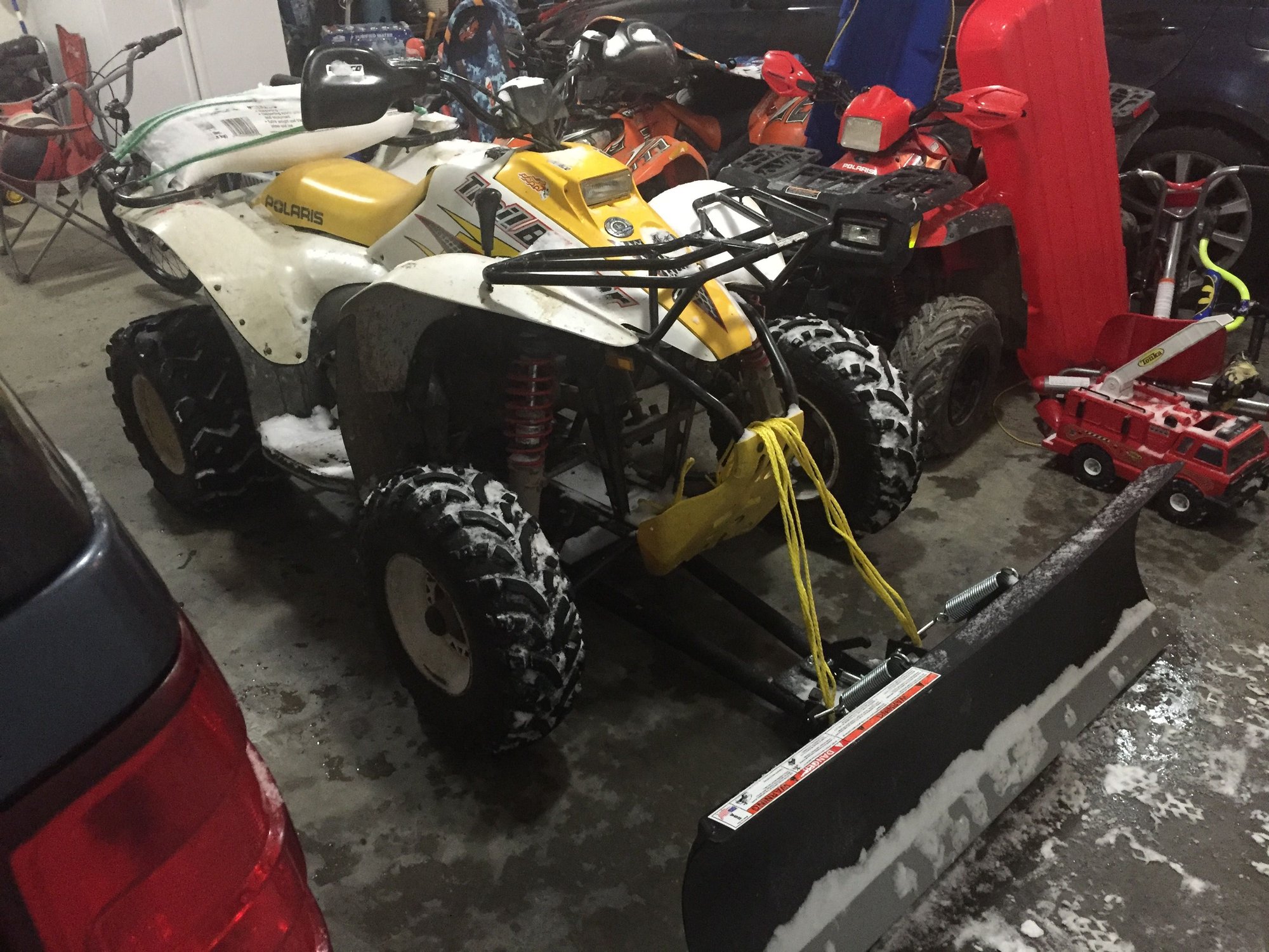

I think the key here was I went with the poly 52" blade that is very light. It made a path slightly wider than ATV and was easier lift. also used rope with bolt attached to front rake to manually raise/lower blade to keep weight down

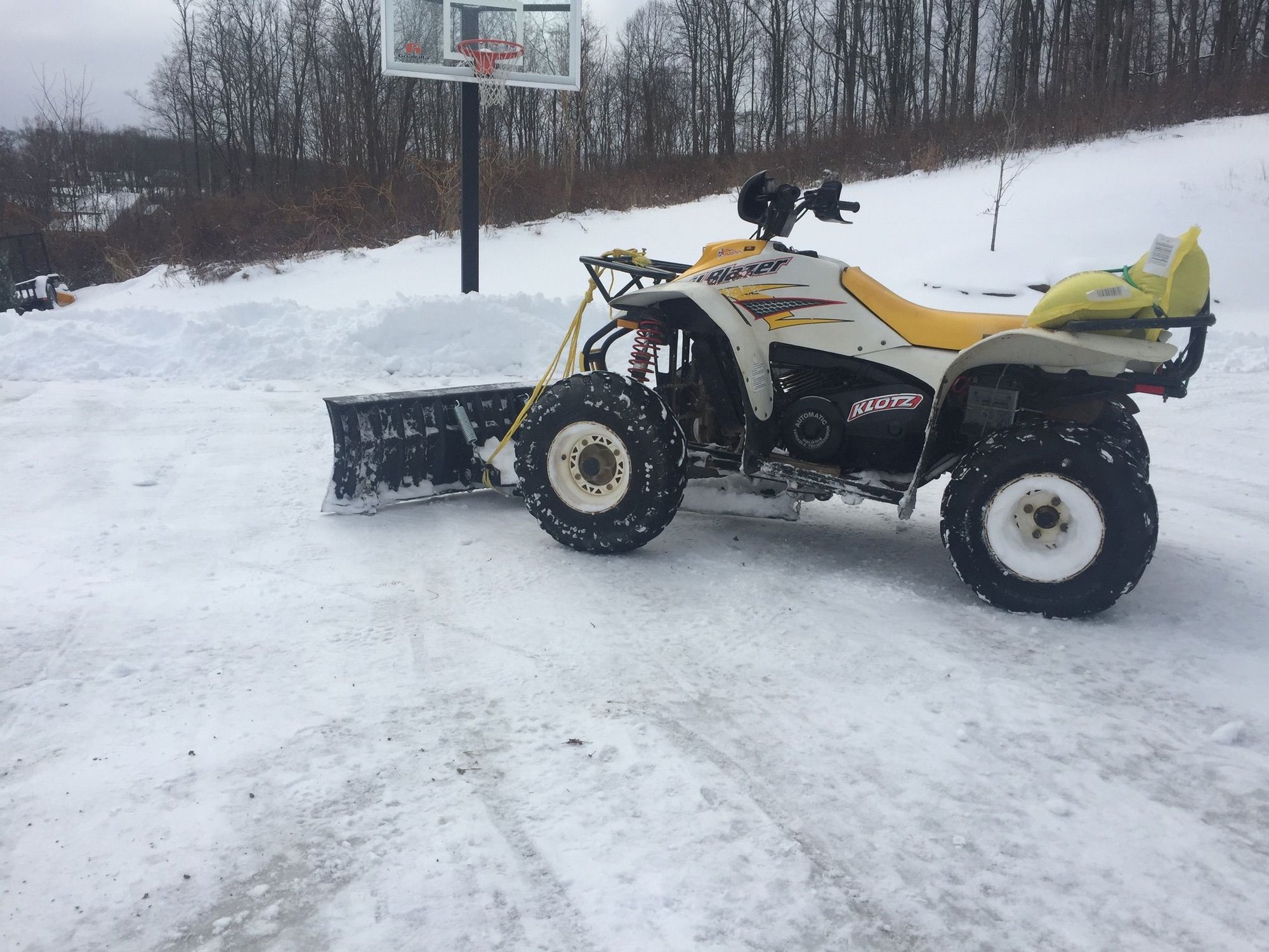

Just installed Cycle Country set up using universal mount and works great. Moved 6-8+ inches no problem. Key is stay on it and don't let snow get too deep.
works good. My driveway is about 10th mile long but down hill. Would lift blade, get a run for it and go back up. Pad up top is 35x70 and level. No problem pushing snow on it. Since bout a Sportsman 4x4, but still have this set up and use it time to time just because it’s crazy fun on the TB.
