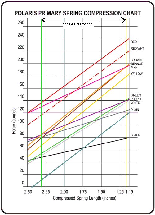

Look at this.
Polaris primary spring compression chart
