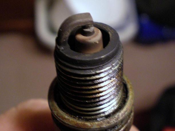

what color was your spark plug when you pulled it out, black or white, white meaning lean, black meaning rich

I don't but I'll see if I can come up with one. I'll see if I can post pics of the old plug as well.

Here is a picture of the plug.
http://pages.suddenlink.net/rraider/plug.JPG

plug looks good.you did put in a new one?The sound clip gives me the idea of the needle and/or tube wore.
