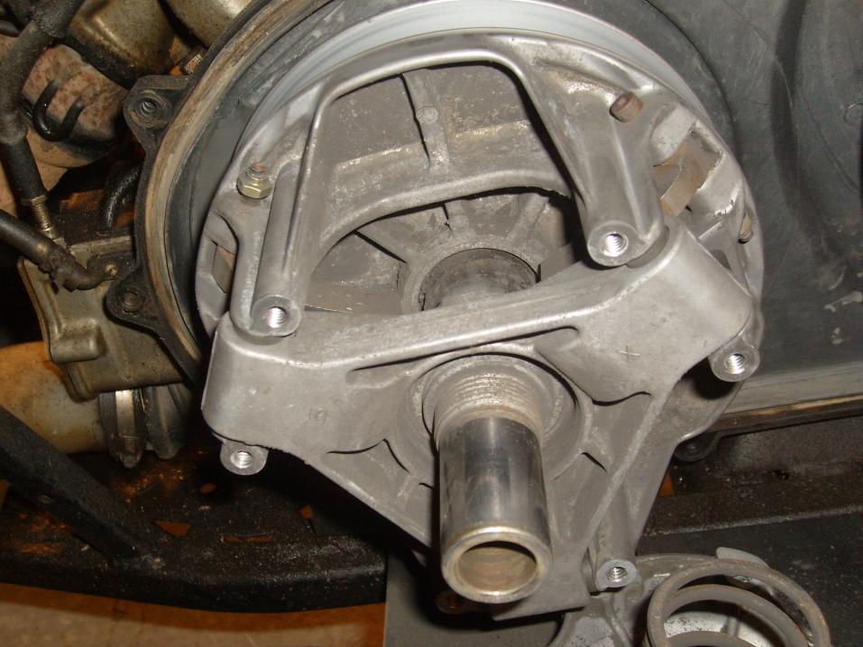

sorry dont mean to jump in and change your guys conversation here just need some help getting my primary off... you guys seem to know a thing or two about the clutch, tricks or tips i need here? thanks

Put it back together and use a clutch puller
