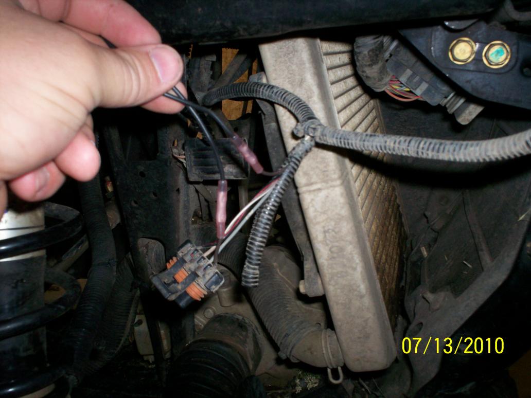

OK guy's, I put my theory to the test and it works beautifully.(So simple a caveman could do it) I'll describe how for the guy's with the 07's w/ADC in the event they would like this option for their quads.
What is needed:
8'-10' of 18 gauge automotive wire
2 weather proof/heat shrink butt connectors
2 female spade connectors
1 toggle switch (your choice style)
zip ties where ever you think it's needed
And I recommend wire loom or at least black tape around the new wires for protection.
To start, Locate the connector running to the front diff. On this connector you'll have 4 wires. Two running to the hub coil and two running to the ADC coil. Locate the ground wire (brown) running to the ADC coil and snip it about two inches above the plug. Connect the butt connectors and new wire to the brown wire you have snipped. (see picture) Next run your new wire up to headlamp pod or where ever you have decided to install a toggle. At the toggle it should be pretty self explanatory. Very easy job and cost less than $10 to do.
