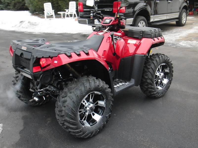

they should fit... I have a set of Motosport Alloys that are or the 08 Sportsman line and they bolted up to my XP.... Only thing is, you will have to get new wheel studs.

wheel studs or lug nuts?
Old Aug 12, 2010 | 12:21 AM
TheATVSuperStore.com's Avatar
Former Sponsor
Joined: Nov 2005
Posts: 711
Lug nuts. The XP used mm and the Sportsman uses inches.
