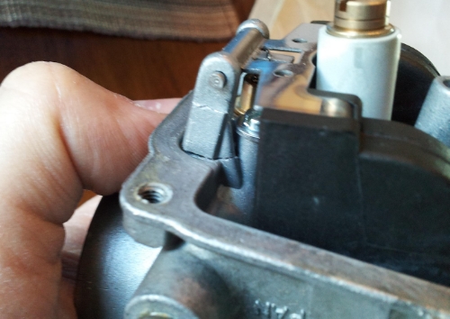

I got home this evening to disassemble and clean the carb out for the 2nd time and look what I found...
One of the posts holding the float pin has completely snapped off! I KNOW that when I reinserted the pin during the rebuild I was very careful and it was not broken then. My only guess (however odd) is that it must have snapped sometime while I was riding. The float has a small amount of slop (side-side and up-down), but it doesn't seem too extreme. I know this might be a lame question, but could this be the cause of the bogging/surging cycle I'm experiencing at the high end of the throttle?
So here's some new questions...
1) Is there a way to fix this or is the entire carb shot?
2) If I do need to replace the carb, should I go with something different or stick to the original?
Thanks for any help!
Edit: would a carb off a 95 work? I can get one relatively cheap

You're not the first to have done this.
That's why I used a small pin punch and held both posts when I punched the pin out. As far as repairing ones for customers,what I've used is JB Weld 5 minute epoxy and have had good luck.Just make sure you use a q-tip to cover the broken post with the epoxy and none gets in the way of the float bowl gasket or would interfere with the bowl cover.Worst case scenario you can buy a used one on Ebay,but try to save this one first. This could be the source of all your surging problems..http://www.ebay.com/itm/POLARIS-ATV-CARBURATOR-FITS-THE-4-STROKE-ATVs-MIKUNI-CARB-MAGNUM-SPORTSMAN-/390574373062?pt=Motors_ATV_Parts_Accessories&hash=item5af00bf8c6&vxp=mtr
