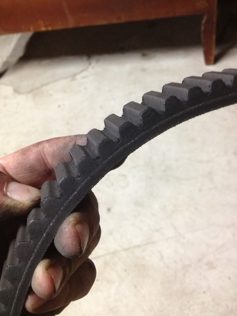

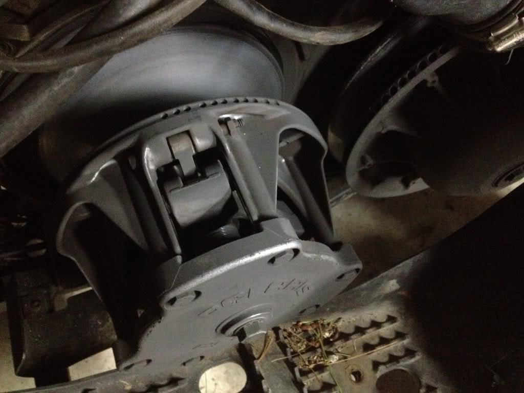

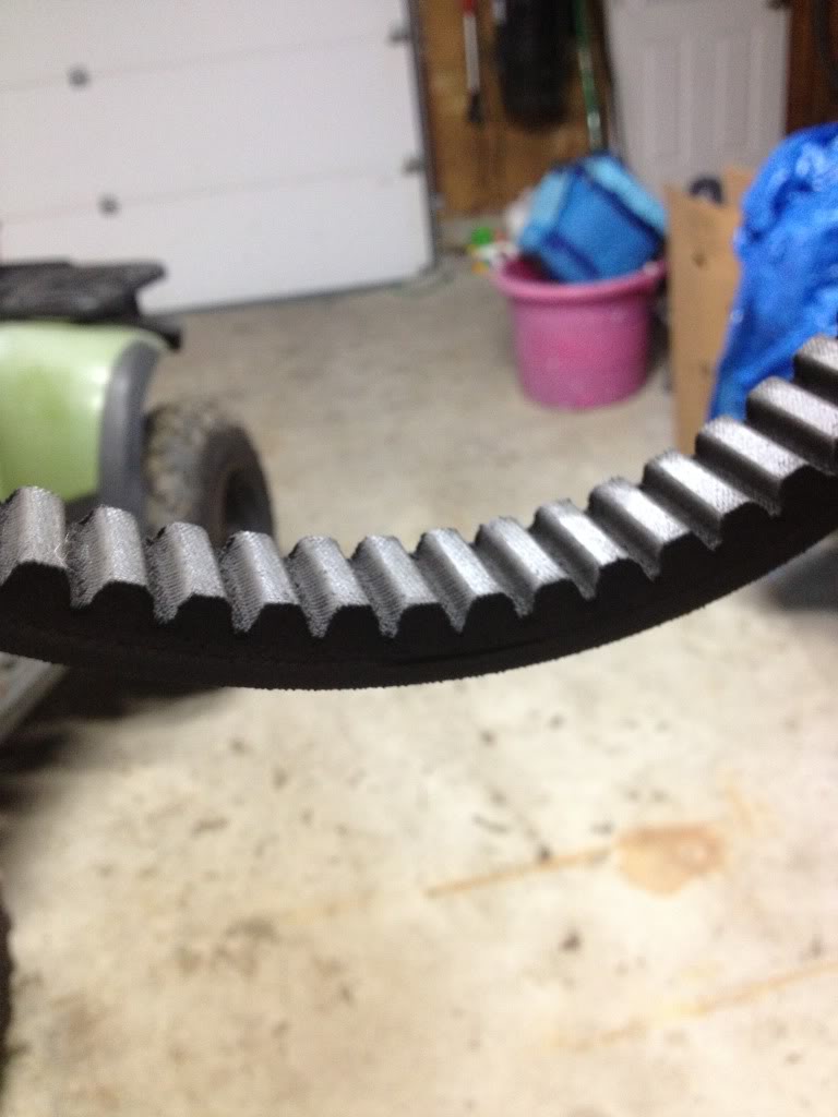

so i am at my parents working on the wheelers. decided i would take the clutch cover off on the sportsman and i find it pretty blackish color in there.. the belt doesnt look bad. i messed with the shifter a lil bit and find that if i put it in gear and turn the secondary clutch it will pop into gear but if i just click it in gear without turning the clutch its a hit or miss. sometimes it goes into gear good others u have to spin the secondary slightly for it to go in the rest of the way. is this a linkage problem? it seems like its not going in all the way until i giv the clutch a lil turn.
i took some pics of what it looks like behind the clutch cover. can anyone tell me what i can use to clean these clutches? is there anything i can spray in there to clean out the belt dust? and can anyone tell me if this belt looks ok or should it be replaced? my dad drove it and he says it takes off good but once it shifts it just falls on its face and gradually accelerates. thought maybe this would be a clutch issue. here are some pics

The dust is normal. I just use brake rotor cleaning spay to clean mine every time I change the belt which is every 2000 miles even if the belt still looks good.
You should get you clutch buttons checked ,there a cheap part but when worn really kill your performance.
Read this. Changing the clutch buttons. - Polaris ATV Forum
Old Aug 3, 2013 | 09:12 AM
Clean it like suggested,blowing out the dust first in an open area,will make a dust storm and a lot of cheap brake cleaner from Wally World,or If you happen to have a clutch puller and a parts cleaner,even better on cleaning clutches. As far as having to turn the secondary clutch for it to lock in gear,this is normal because of the straight cut,not beveled transmission gears.They don't just slide in and lock like motorcycle gears.The engine has to be running for it to shift normally. Don't forget to have the rear clutch ramp buttons checked/replaced along with the front. This in my opinion is the most best clutch system. Easier to work on,hardly any creeping problems that the later ebs clutches had. 4 strokes have a natural braking system from the engine itself.Belts are cheaper too than on the later models. When back together,place a straight edge over the top of the clutches and pull down on the center of the belt. If the distance is greater than 1 1/2" from the top of the belt to the straight edge,it's getting close to time for a new belt.
