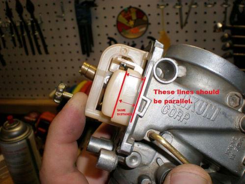

If you just cleaned the carb and didn't replace any worn parts,it still could be a carb related.Parts that wear the most are the needle valve and o-ring and the slide needle on this model.Plus on this model the float setting is critical.

Ill have to look, i have a Manuel but it only says how to set the ones with metal on them all i have is 99% plastic and little metal on the needle.
I do not see a long metal piece to set
Far as o rings i did change them
Old Sep 7, 2013 | 06:38 PM
Needle and seat(needle valve) is a critical wear item and hard to tell just by looking at them if you just cleaned them. Here's a breakdown on the BST40 Mikuni carb that's similar to yours that's used on a KTM.The BST-40 Bible - ADVrider
