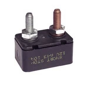

Thank you -I figured that much out after fiddling strange location for a start button. but still no go. No lights no crank. I know,it worked when I picked it up. Shouldn't lights work when running even if batter is dead? Thinking might be a dead fuse?
Old Dec 26, 2013 | 06:15 PM
Lights should work when running,BUT surges from the regulator rectifier to a dead battery that wont accept the charge has to go somewhere. The path of least resistance is the bulbs. I've had to replace my share of these over the years.I'd be careful on jumping off from an auto battery. Best just to get the proper battery for it.. Also there is a 20 amp sealed circuit breaker up from the battery usually tucked under the fender. Check that you have power on each side of it. Not unusual for these terminals to corrode and not allow power to the ignition,etc.Item #2. If bad any auto shop should have them. Dirt Cheap Yamaha, Honda, Arctic Cat & Polaris OEM Parts & Accessories – Cycle Parts Warehouse

Old Polaris tech thanks a million. I installed a new HD battery and still nothing then I realized that since the on off switch and reverse didn't work it was either a connection from the battery, solenoid or said 20amp connection. I thought I'd take the switch assembly apart to see there was power there and clean the connections when I noticed the plug was loose. I put some dielectric on it and plugged up tight and whalla starter, reverse and lights work. Starter makes an awful hanging noise but everything is working. Thanks again.
