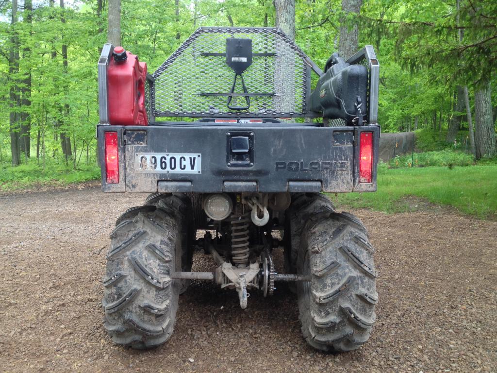

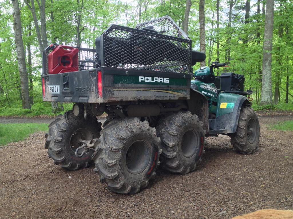

#24
Attachment 13975
Attachment 13976[/QUOTE]
Dying to know where you bought that cage for the dump bed... Was it a homemade thing or did you buy a kid from somewhere? Looking to buy a big boss primarily for moving large amount of already split firewood and that cage is literally exactly what I was looking for
