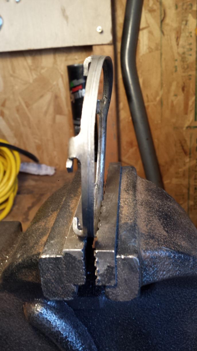

I am wondering if I can get some input on the differential in my 2007 sportsman 500 HO EFI. It has been an ongoing problem; heavy steering, binding, and pulling right or left. The AWD has always engaged/disengaged properly though. I had a really hard ride the last time out and I thought it was time to investigate. I pulled the diff and I found the armature plate? was twisted and torn in a few spots, both output hubs have worn/torn spots, and some of the pins that stick out of the ring gear are gone.
Are the pins in the ring gear replaceable?
Is the wear on the outer hubs too far gone?
Is this more money in parts then a complete remanufactured diff?
Thanks for your input

Doesn't show that they are. Pinion assy shows to have the pin. Best to replace both ring and pinion gear as a set or it won't last,but costs almost as much as a complete differential. Give this place a call and see if they can help.Rox Technologies :: Polaris Not necessary to post twice on the same problem in normal and expert threads.

Thank You Old Polaris Tech for your post. I will get a complete gear box for this thing. It sucks because the old one still works; but for how long is the question. I apoligise for my duplicate post.
