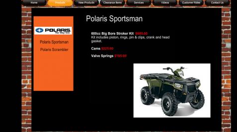

I am mechanically inclined, and have a Polaris service manual for my 2012 400HO, wonder if teardown and rebuild is something I could do myself?
Want to upgrade it a little...
Welcome to 4 Stroke Tech, Inc.
Will only need to get the jug bored out, and add a BST40 with a 175 main jet, and all set.
Attached Thumbnails 455cc Fuji - ease of teardown & Reassembly??-screen-shot-2014-09-13-3.58.49-pm.jpg
Old Sep 14, 2014 | 10:07 AM
If you're talking about a big bore kit,they usually come with a new cylinder and piston,etc.You have the same rod stroke as the 500 engine(75mm) but bore size is smaller. 87.9 mm versus 92 mm.Manual calls for max .020 over stock bore (50mm) but aftermarket oversize pistons are available past that. Wiseco has them for the 500 but not the 400 even though it's 455c versus the 499cc for the 500. On the big bore kits to get to 600ccs most times the original cylinder sleeve has to be pressed out,the bare aluminum cylinder bored out and the top of the cylinder chamfered to accept the larger pressed in sleeve and piston. To try to do this with a stock cast iron liner would leave it paper thin if you could even do it.Wouldn't hold up.You can go with a big bore kit or you can look at other alternatives also if looking for more power.Aaen Performance - Polaris ATV Four Stroke - ATV Accessories

Is a 95 mm piston going to require major cylinder work?
Old Sep 15, 2014 | 04:27 AM
You can't bore to that limit on the 400. If you could the sleeve would be paper thin and wouldn't hold up. Yes you'd need cylinder work/new sleeve.You're talking about jumping over 7mm up from stock 87.9 mm bore. In good old American terms that's over a quarter of an inch bigger bore. If you're really looking for more power,might be time to trade up to a larger machine than by making a good reliable machine less reliable. Just my
