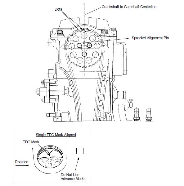

Average compression should be between 55-90 psi or so because of the decompression feature of the cam shaft. Check your exhaust cam lobe as they had problems with soft heat treated cams on the 1996-2000 500 engines.Hard starting,popping back through the carb was a couple of the symptoms. Here's one that was ground down on a Scrambler 500. Bad Cam Pic - ATVConnection.com ATV Enthusiast Community Plus if the cam is ok,simple things like a cam detent lever return spring broken or out of place,stator timing off, can make turning the engine over hard on the electric starter.
Attached Thumbnails 96 500 sportsman-2011-05-21_125845_00_polaris_500_cam_timing.jpg

Old Feb 13, 2015 | 12:21 AM
This may help along with cam lobe measurements that's in the manual.

Ok so checked the auto Decomp ball is there and counterweight springs back Reset valves to 006. Not much difference..
Looks like I need a new starter, this ones too weak.
Cam lobes look good, minimal wear.
