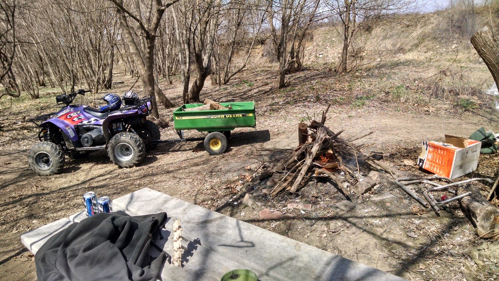

1ArmBandit's Avatar
Joined: Jan 2013
Posts: 440
From: quad cities IA/IL
this is today with my 6 yr old..
