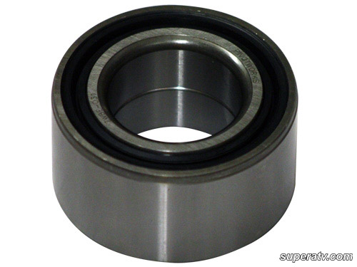

Great thanks for the info.I thought that was the correct locations for the fluids but wanted to double check. As far as my hubs go what is being lubed in there just wheel bearings or are there some type of clutches in the hubs?
Old Apr 23, 2015 | 07:01 PM
Just a big old double race bearing like this one. 40x74x40mm.
