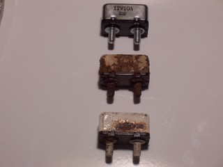

Old Sep 4, 2015 | 03:32 PM
Did you check if the small wire at the solenoid powers up when you hit the start button? If it doesn't you have problems else where. Plus do you have power to the lights,dash,etc? If not the 20 amp circuit breaker may be faulty.Located up from the battery on the frame. Item #2.Dirt Cheap Yamaha, Polaris, Suzuki & Kawasaki OEM Parts & Accessories – Cycle Parts Warehouse IF you do have power at the front,power to the solenoid wire but no power to the starter,then probably a bad solenoid. Use a test light or a meter to check starting at the circuit breaker if need be.

No lights at all anywhere...

Old Sep 4, 2015 | 03:48 PM
Check that you have power on each side of the red wires leading into and out of the sealed pouch located up from the battery.If you have power only from the battery side,split the pouch and check the circuit breaker. Usually they get corroded and short out. You can get a 20 amp breaker at any auto store for a few bucks. Here's what some can look like.This supplies the main power to the dash,ignition switch,left control switch and lights!

Would that be with key on and switch up?
