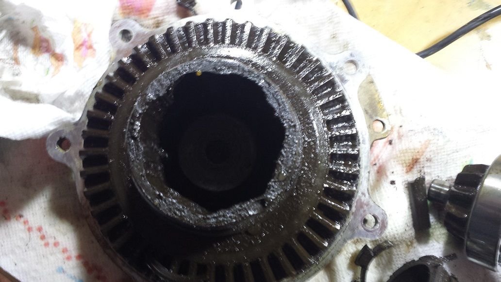

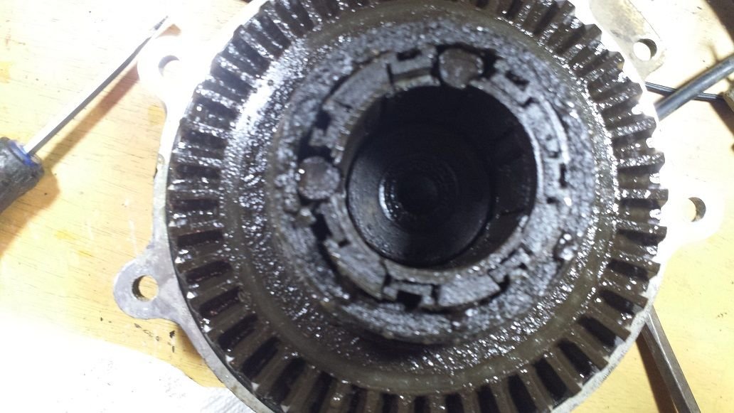

Old Dec 17, 2015 | 08:59 AM
m2cyclone's Avatar
Joined: Dec 2013
Posts: 82
Here is what I'm working with..
I'll post rebuild pics during.
Most of the crap on the Ring is dirt and old grease, actually wipes off, but still has a light coat of surface rust.
Old Dec 17, 2015 | 09:32 AM
Nasty but I've seen worse.. Changes took place even as the parts lists were made on front diffs. If the roller cage didn't have the retaining rings,don't see why the new cage would need them. Plus I hope you're installing a new aluminum cage or at least a sturdier one from a JD that some have used.
