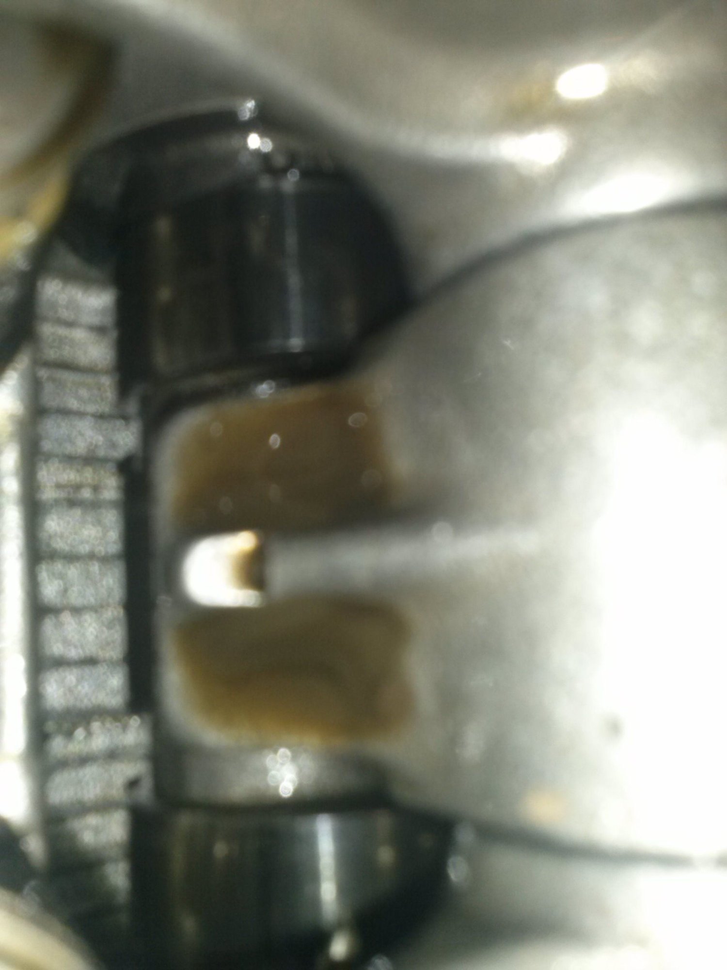

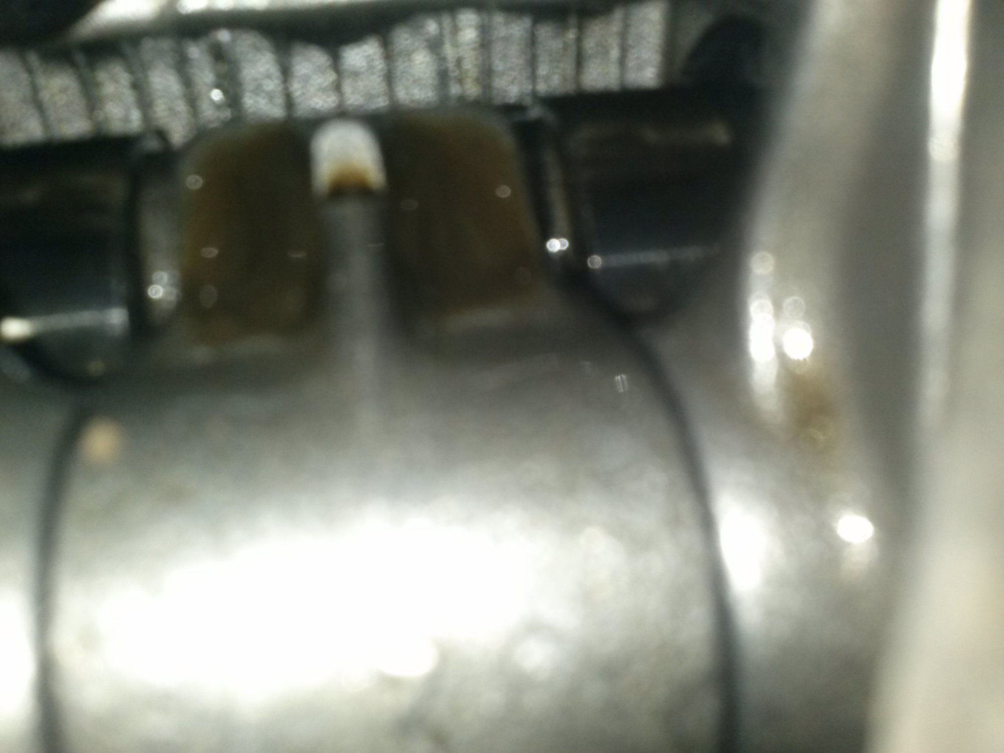

ok so i found the black wire it was coverd in dirt so i took it out it dident fix the cutting out issue .. but it did how ever fix my stalling isssue when i put the atv in revers i hated having to use the overide button cuz then it made it hard to pull the break lever ...... is there anywaay i can inspect the camshaft without taring the engine apart ? can i just pop the valve cover and look or is it not that simple... ?

Just pop the valve cover and bump the engine over. Visually check the cam lobe for wear or any scoring. Glad defeating the limiter helped at least on reverse. This is where they would hit first when limiters were faulty,then some would cause limiting in forward range.

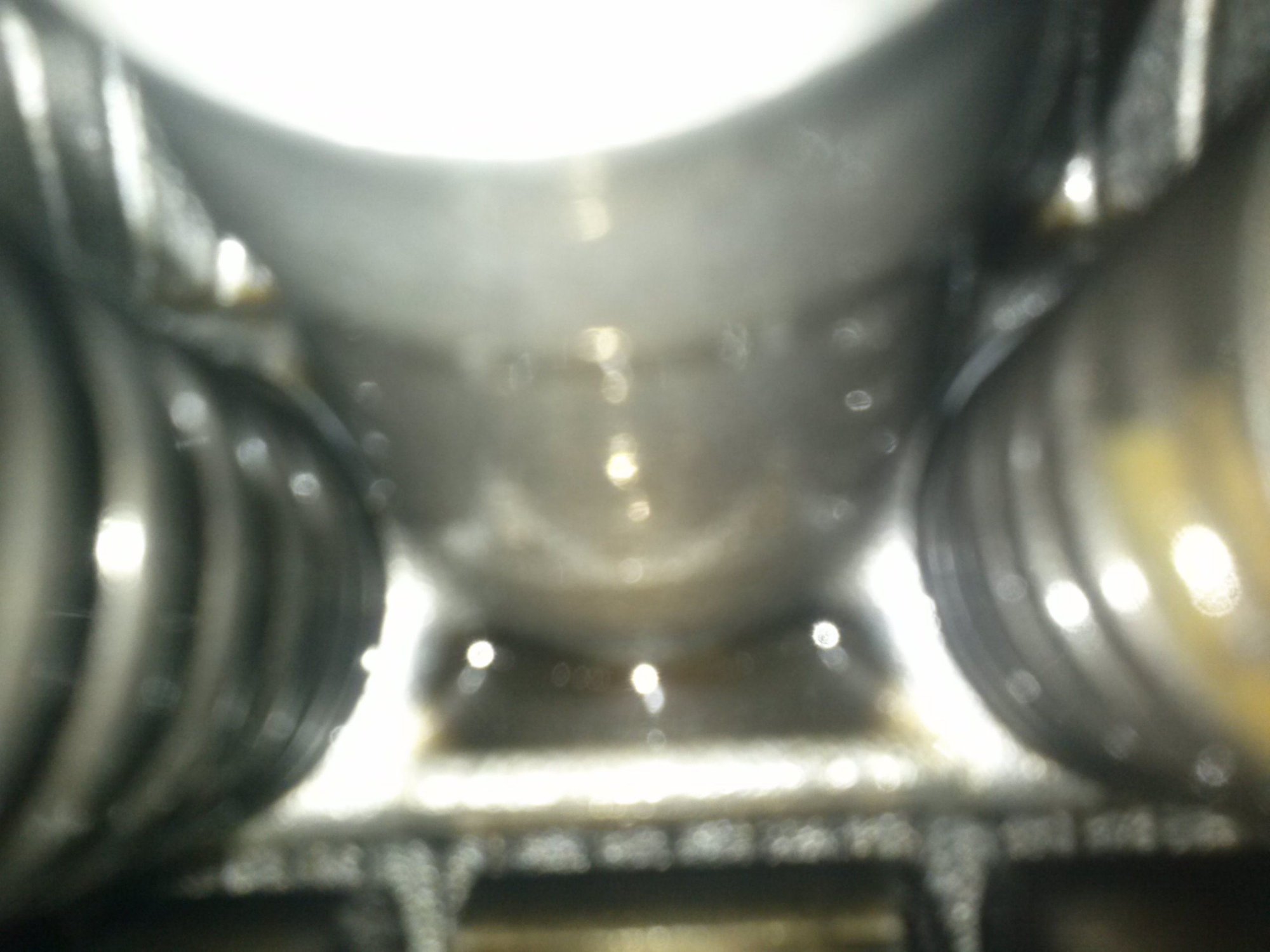

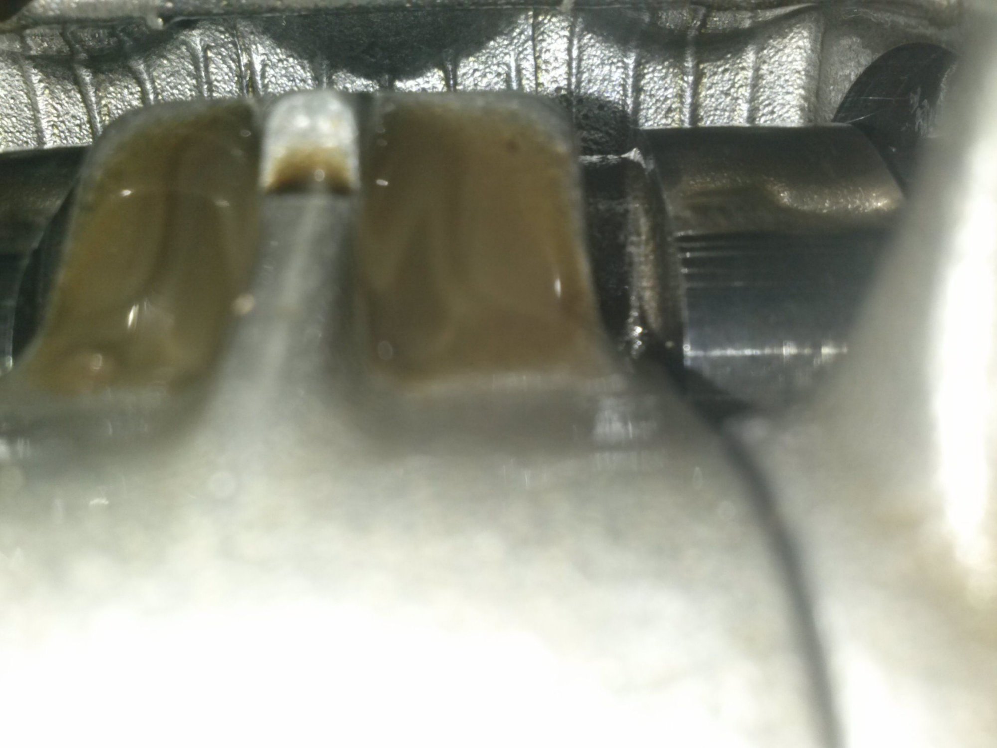

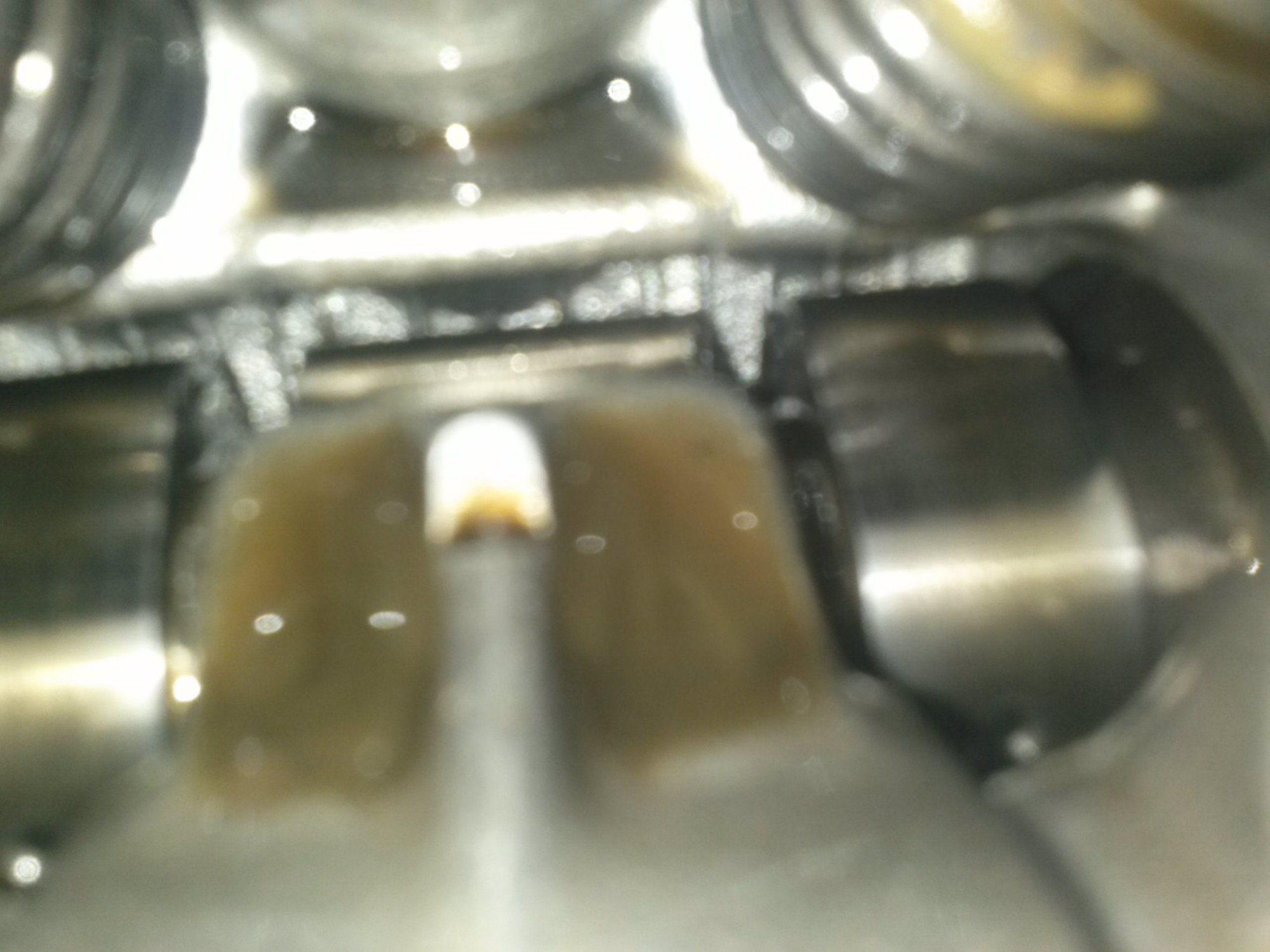

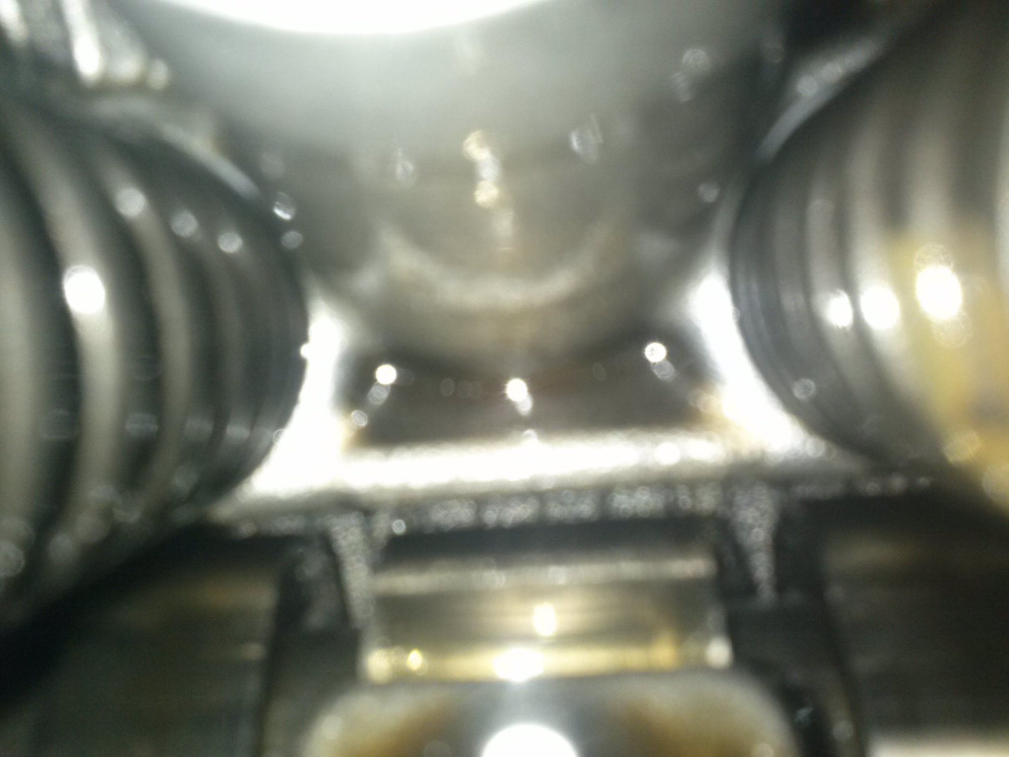

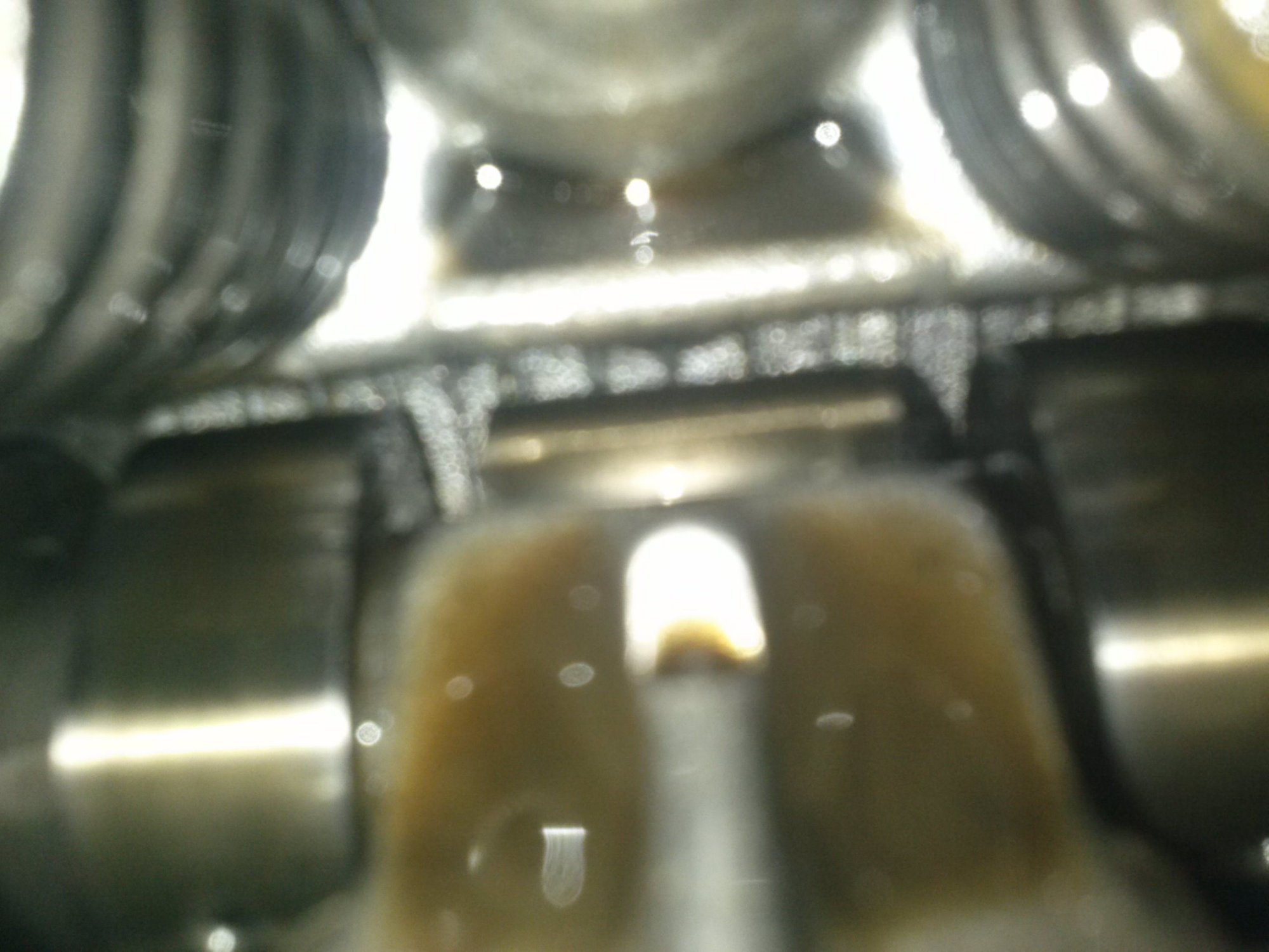

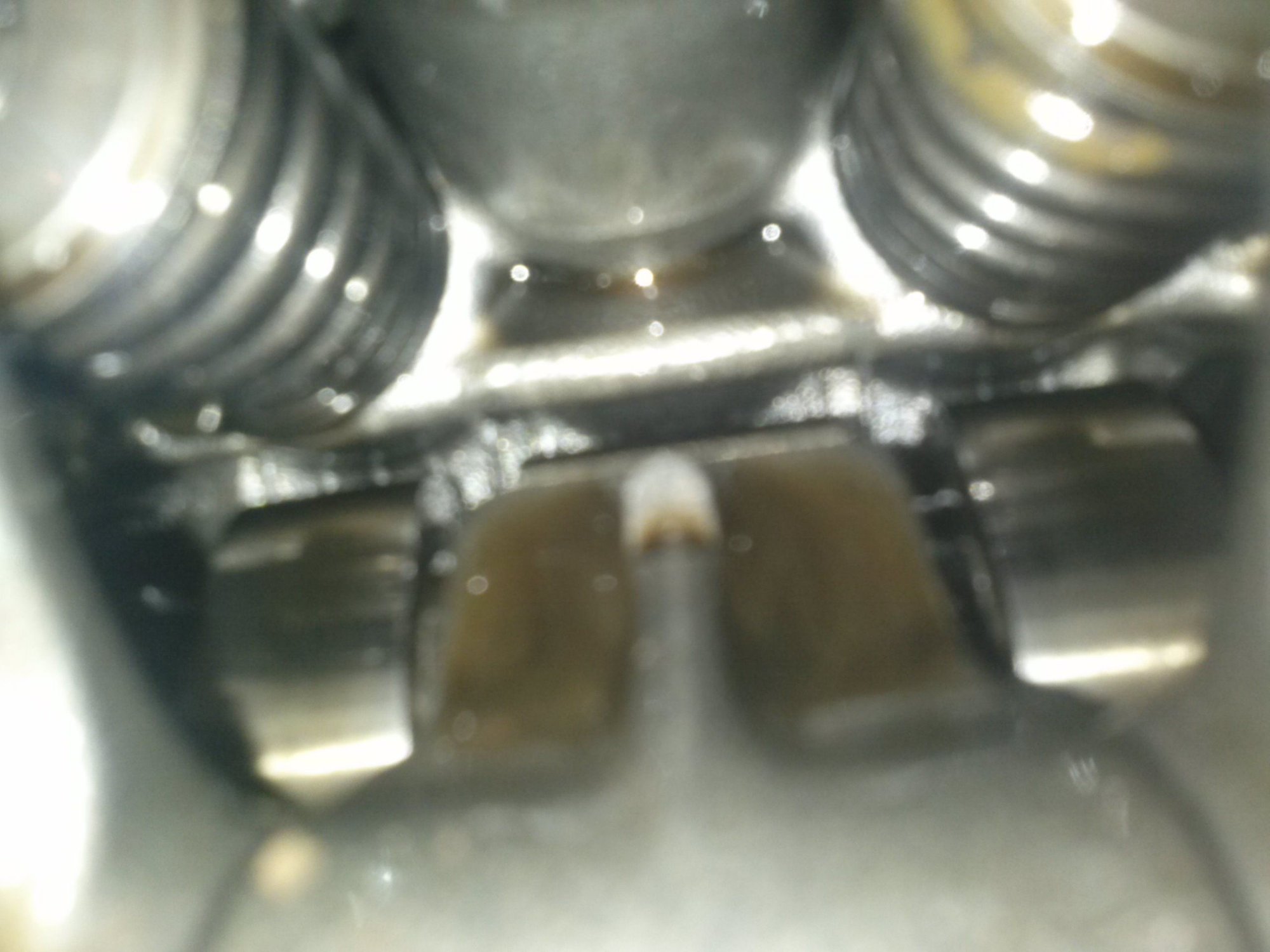

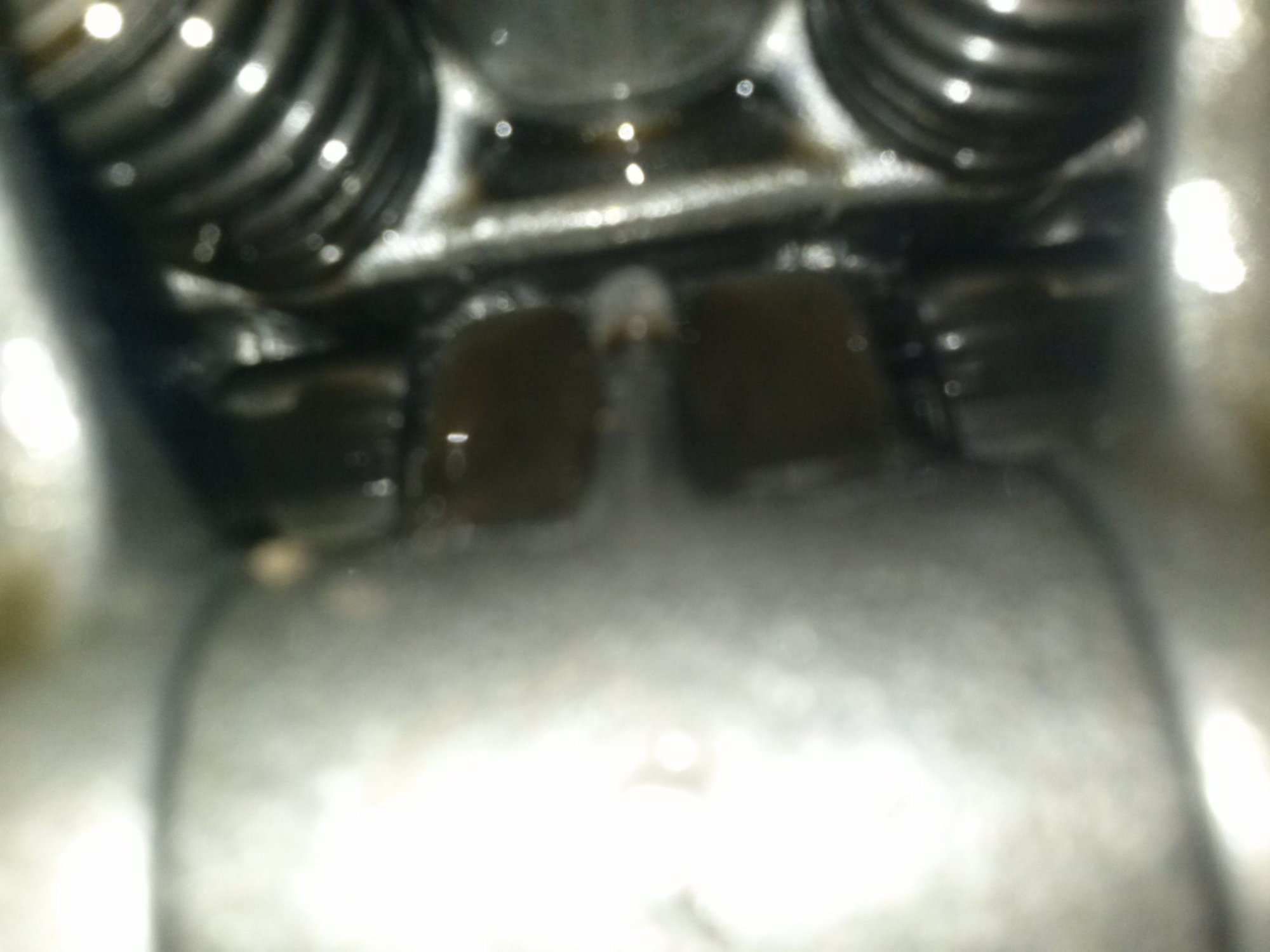

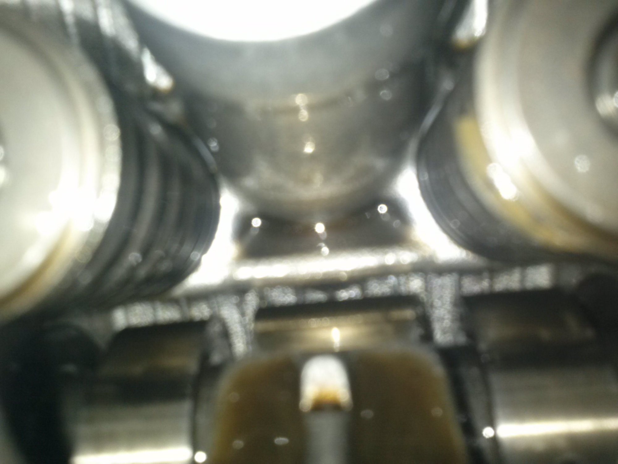

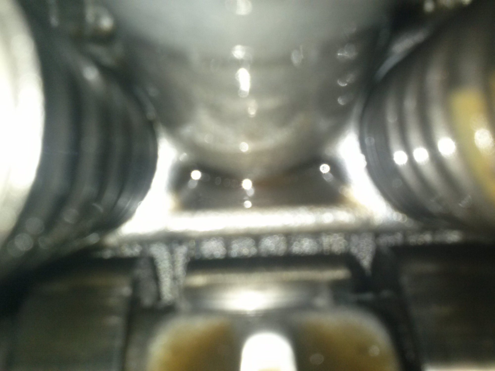

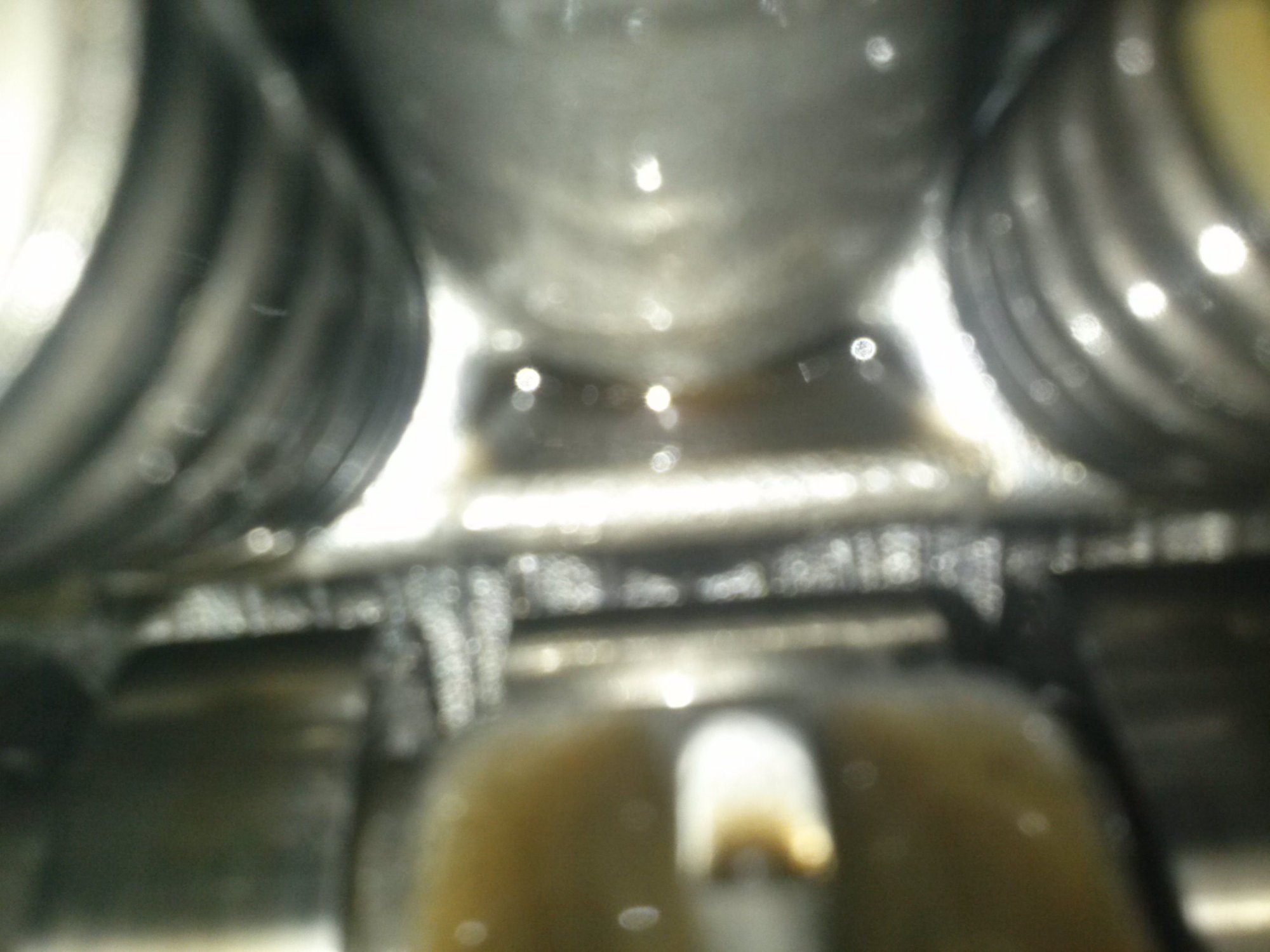

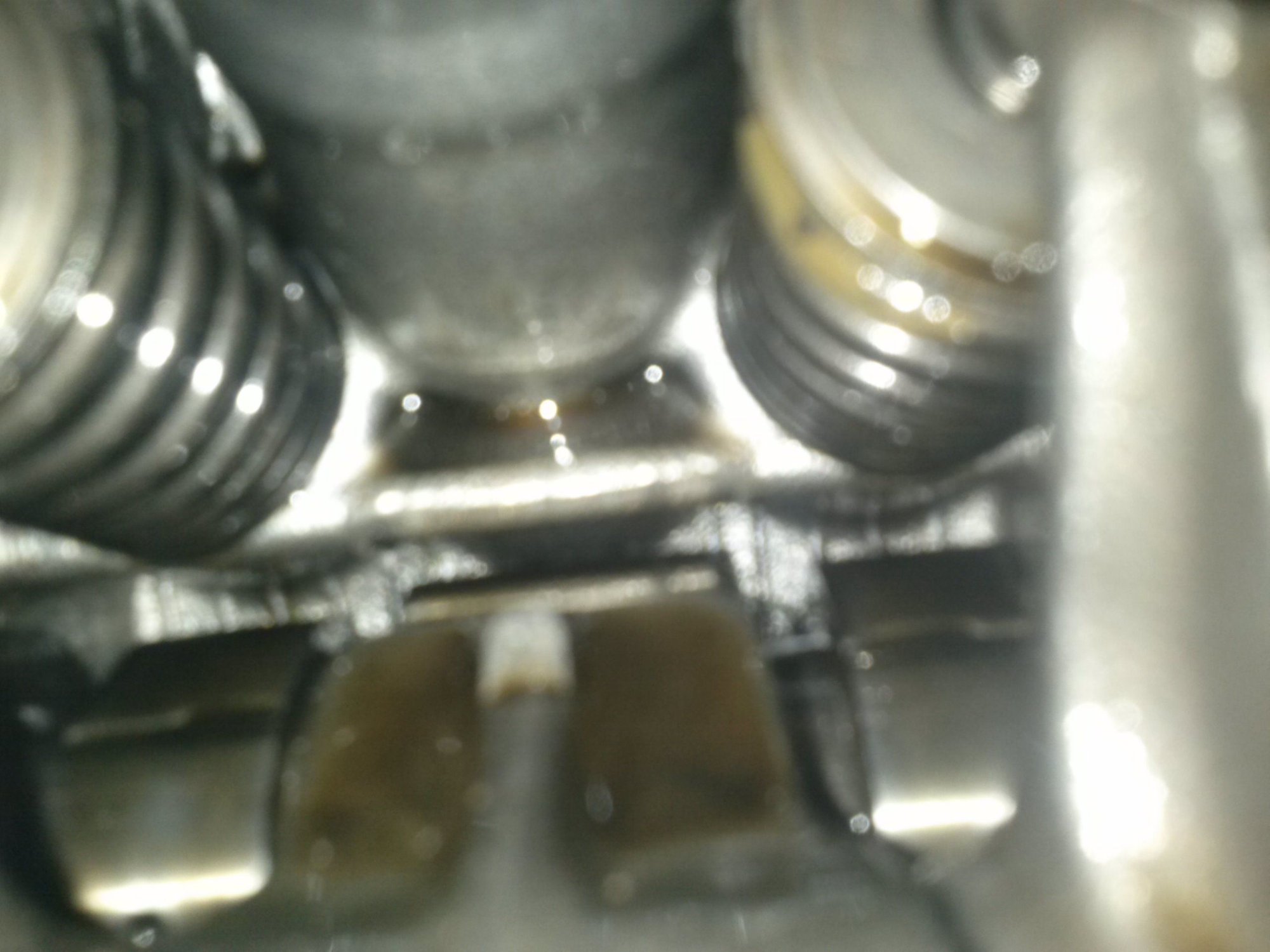

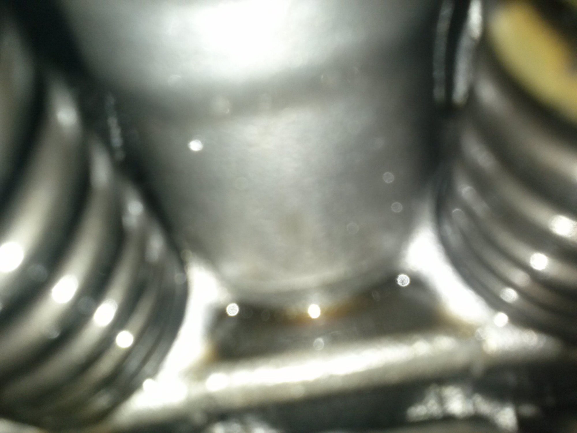

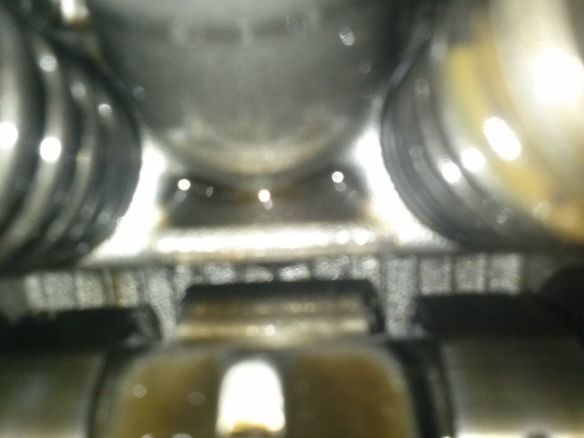

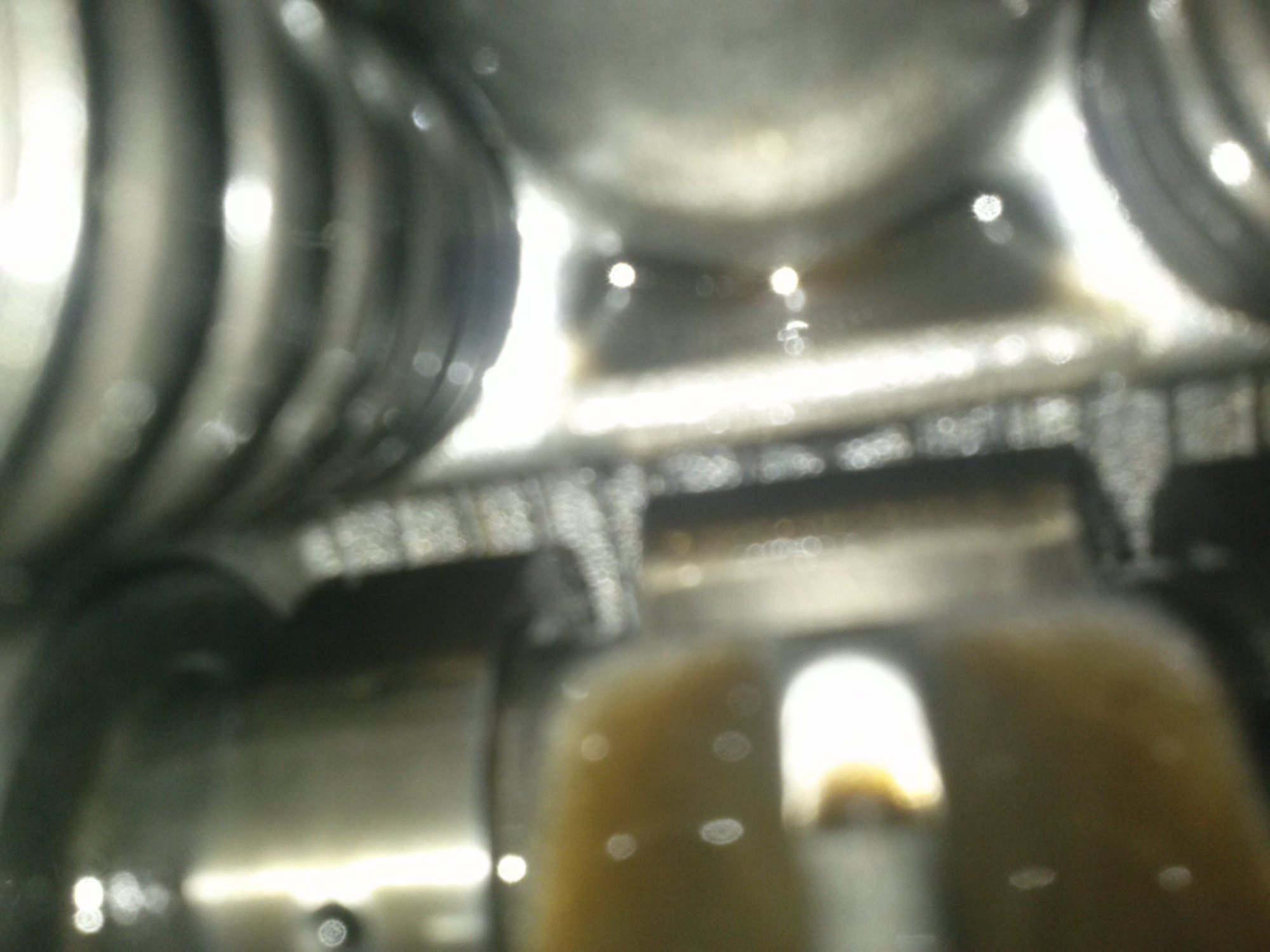

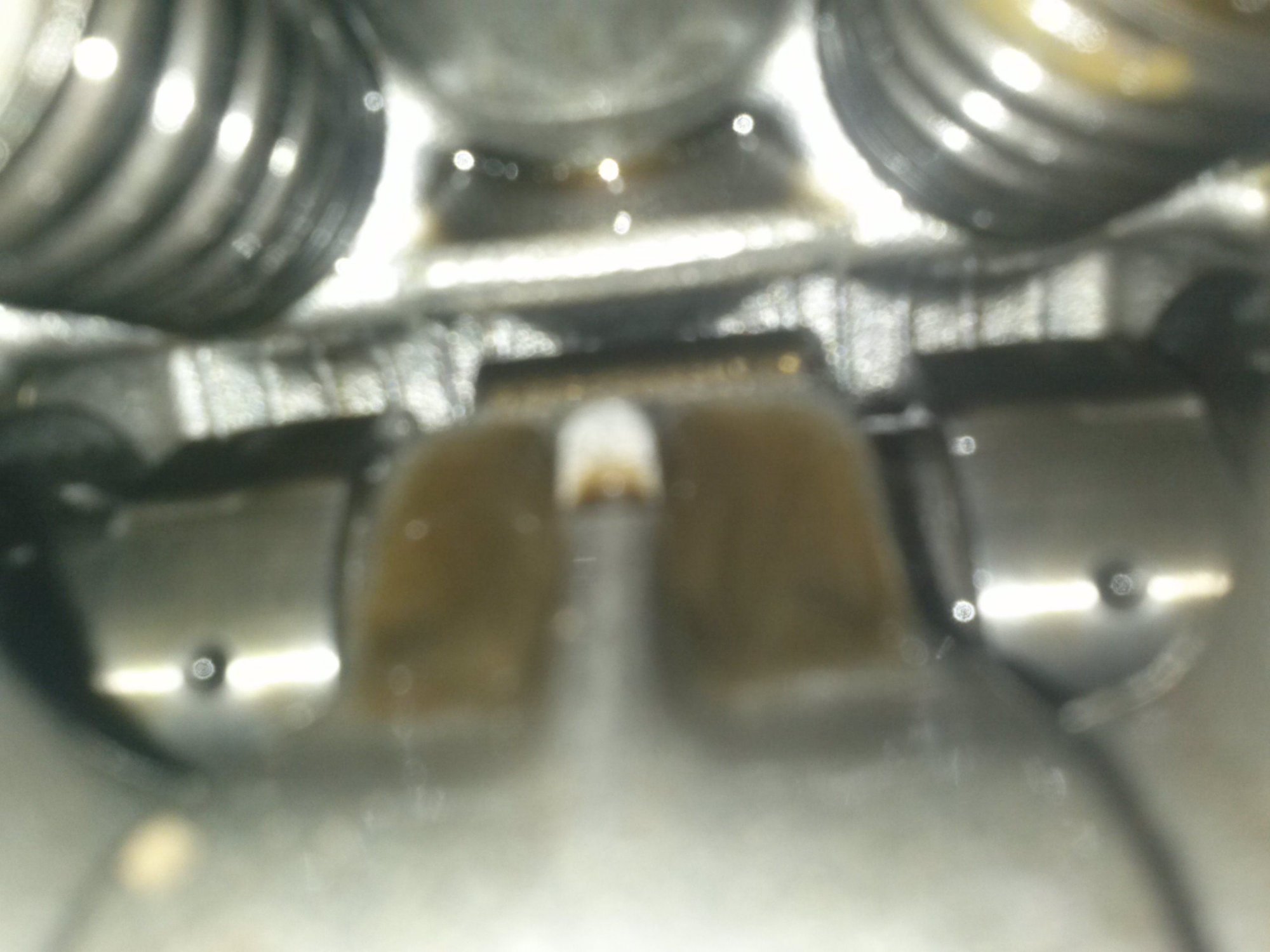

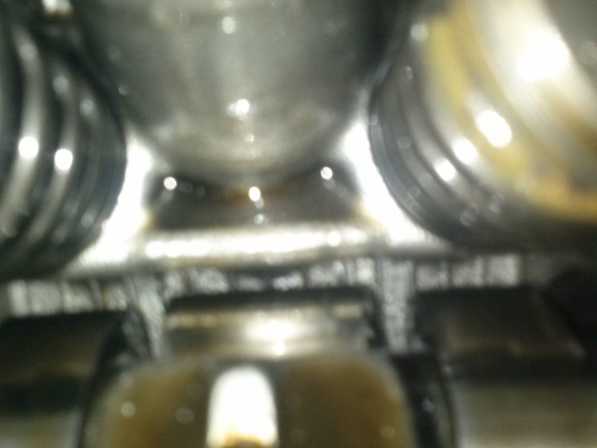

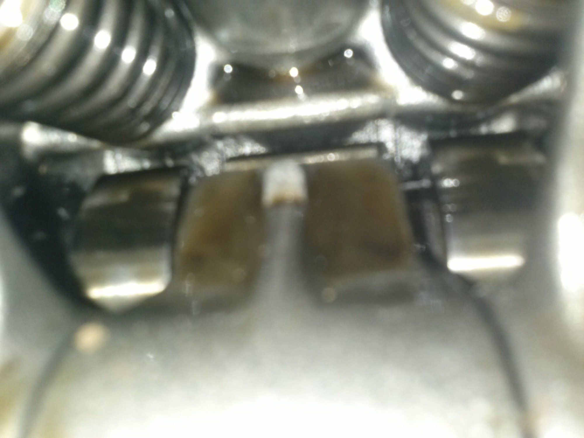

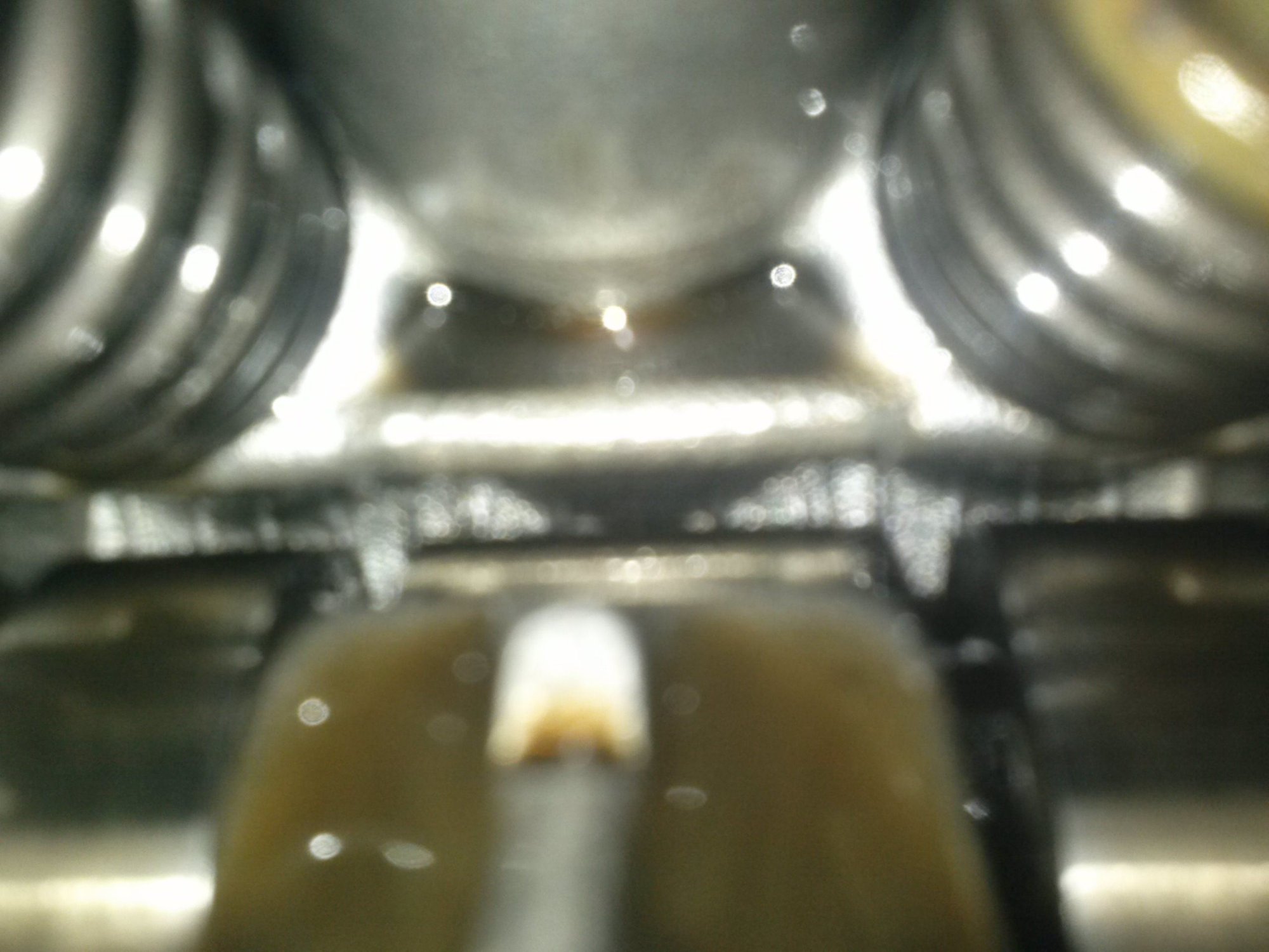

ok so i got sum camshaft pics there is quite a bit so im sorry about that i dont know what its supossed to look like but there i is other than a couple scratches it dident see anything
