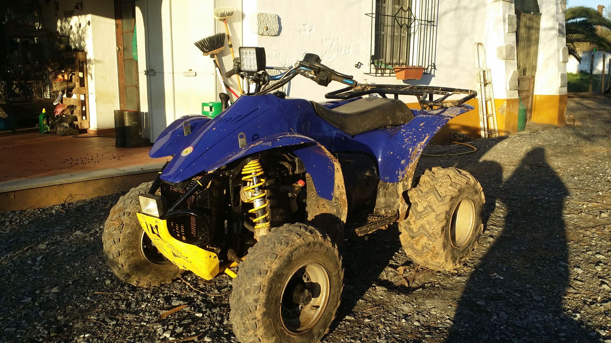

So I have my 2003 Scrambler 500 4x4 finished. Painted. Wiring sorted and changed seals and bearings on left front hub. Had no oil in it. Did a full service on it.
While it was in the shop waiting for the hub seal to arrive (waited a long time and they actually sent the wrong ones so I had to wait some more) I did what seems like a popular mod online. Cut the back out of the original muffler, put a tail piece on it and cut off the original tiny elbow that came out the bottom. Sounds great! Now it seems some people say you need to change the jets after an exhaust mod. Is that true? Also made a new front bumper as the original one was bend.

only way to really tell is to look at your spark plug i think...scrammys were jetted fat out of the shop so u might be good

Most of the time on an exhaust change only,jetting doesn't have to be messed with. Occasionally an adjustment on the fuel screw or needle clip position change might be needed if it hesitates or bogs. What most people don't realize is that a less restrictive air filter system affect these machines more on jetting than an exhaust system alone does. Pull the air box off a Sportsman or Scrambler and they don't run worth a flip as jetting is tied in closely to the filter and air box being installed.

what are those metal looking things coming out of your front fenders? never seen that before

Don't know. Maybe to fix a front rack? They were there when I bought it.

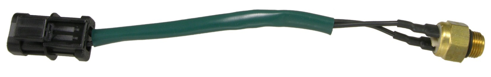

Fan is hot wired, temperature switch must be bad. Haven't connected the switch yet , might actually be working but I doubt it. The previous owners had the bike to pull tarps under the olive trees when harvesting. So not much driving. So they may have hot wired the fan to be constantly on.

Just get one of these for the radiator and you won't have to have the fan hot wired.http://www.autozone.com/cooling-heat...077_5285_4299/

Wells SW526 is the sensor. You would have to cut your connector off and reuse it to match up with your wiring harness but no big deal. You can get these at any auto store,ebay,Amazon,etc. Whoever has the best price.It fits all models that take Polaris Part #4010161 including yours. Even Caltric has one for 26 bucks on ebay..http://www.ebay.com/itm/COOLING-ENGI...JWLqDU&vxp=mtr
