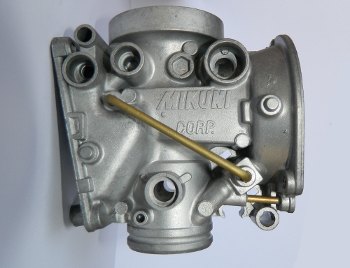

I have an 2001 500 sportsman with an broken external brass tube to choke chamber from carb does anyone have quick fix for this??Thanks in advance

Bummer.. If the fitting just came out at the bottom it can be jb welded. If it's broken at the top where the choke plunger goes in the opposite side,then that's a tough area to repair. I've had these break at this point and a small portion of the tube was lodged in the carb.I didn't have too much luck with any type of repair that would hold on this area of the carb.

Thanks OPT Yeah its broke off in both area with an little piece still inside of carb body

Not good.. Ebay is your best bet either for a used carb or you might look at the Chinese HO knockoff carbs to see if one might work.
