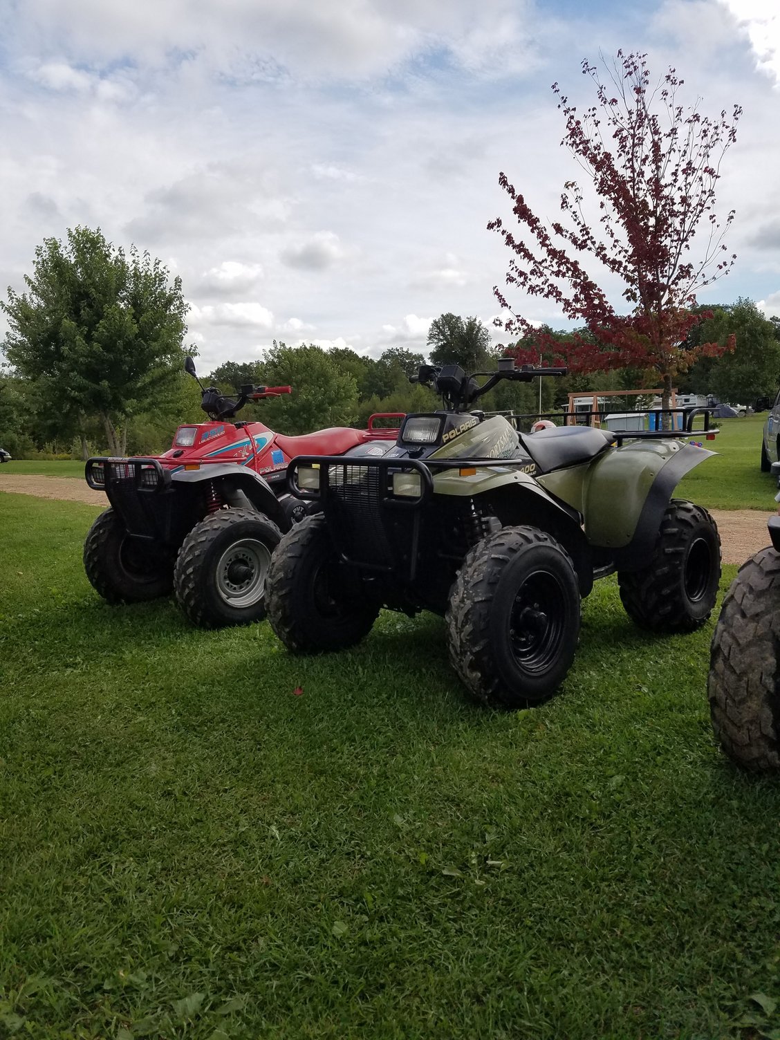

I got some time to get the 97 sportsman 400 up to the campground this weekend. It has been running really good. Just have to adjust the carb a bit after I rebuilt it. Idles good but is a little choppy off idle till about 1/4 throttle so I will put a fresh plug in and adjust the carb. It rides a lot like my 93 350L so I was wondering if anyone had any luck playing with the rear shock setting to get a better ride? I ride with a lot of newer stuff so those guys like to fly with their bigger 570's and 850's. This guy is getting too old to bounce around like that, lol.
