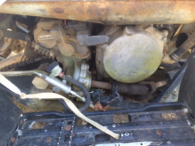

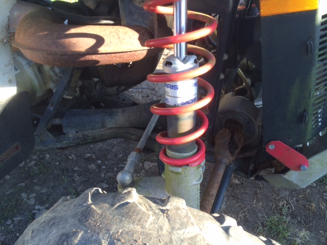

- I uploaded a few pictures. Its actually a little better and more complete than it looks. Just needs a good pressure washing to get the green off of some of the parts and plastic from where it has sat.
