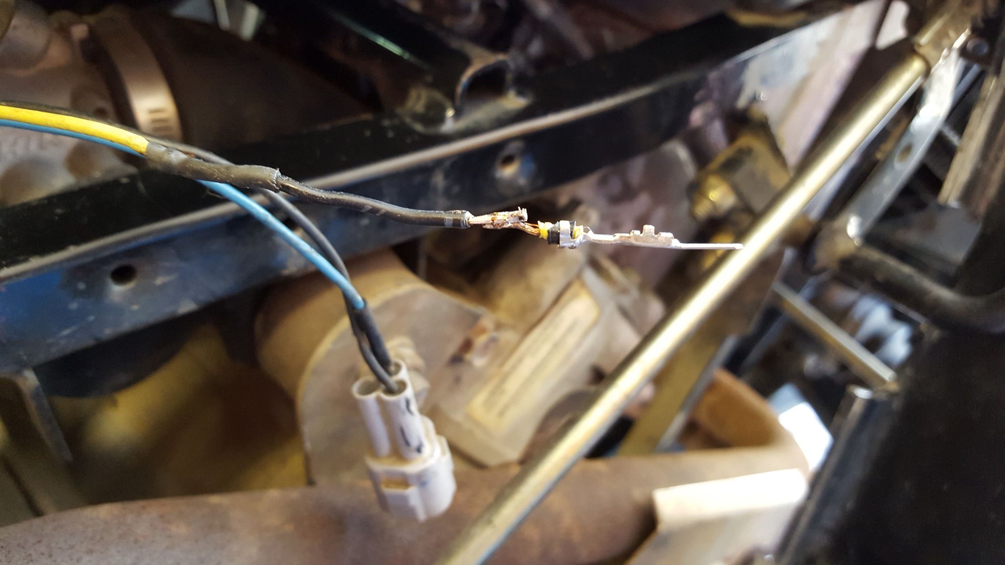

After further inspection and cutting away heat shrink wrap, I found that this wire where it goes into the pin on the connector is broken and only half the wire is still connected to the pin. It also shows that these wires were cut at some point and spliced back together. Can I repair this pin? I can't even get the wire out of the pin I'd hate to order a new sensor if this isn't the problem. Over $125
I removed the shrink wrap on that wire and the wire is actually soldered so I'm not sure if that is the problem. Connection should still be good, it just looked like it was broken but the two ends are actually overlapped and soldered

Which sensor? T-bap or tps? Or is it the connector and wiring that goes into the sensor? If so here's the solution for either one. Looks like you need a new repair kit not the sensor.

It's the male end of the plug for the tps. I would think it is still getting a good connection being soldered together though, no?

Get the 39 buck tps repair harness and forget about trying to repair that crap.. If you luck out and this is the only thing that's wrong with this machine,then you owe me a case of beer.. And I don't even drink.. Look at the "sticky" post section above the expert section on 700/800 efi wiring problems. That's how the aftermarket kits came about from https://otbpowersports.com/products/ The ones I had to use from Polaris sucked,wouldn't hold up and had the same thin wiring you're dealing with now.. If mine I get the t-bap repair kit too as they are the ones that are most prone to fail.. AND by the looks of it the po tried to repair this on his own,too cheap to do it right.
