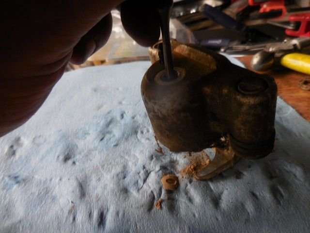

Front caliper:
The left and right are mirror images of each other. Only difference is the right has a cup and a screw for the speed sensor.
Using a punch through the banjo bolt hole to drive the piston out. The bottom of the pistons are pretty thick.
I have been lucky with this so far. The bore is great.
