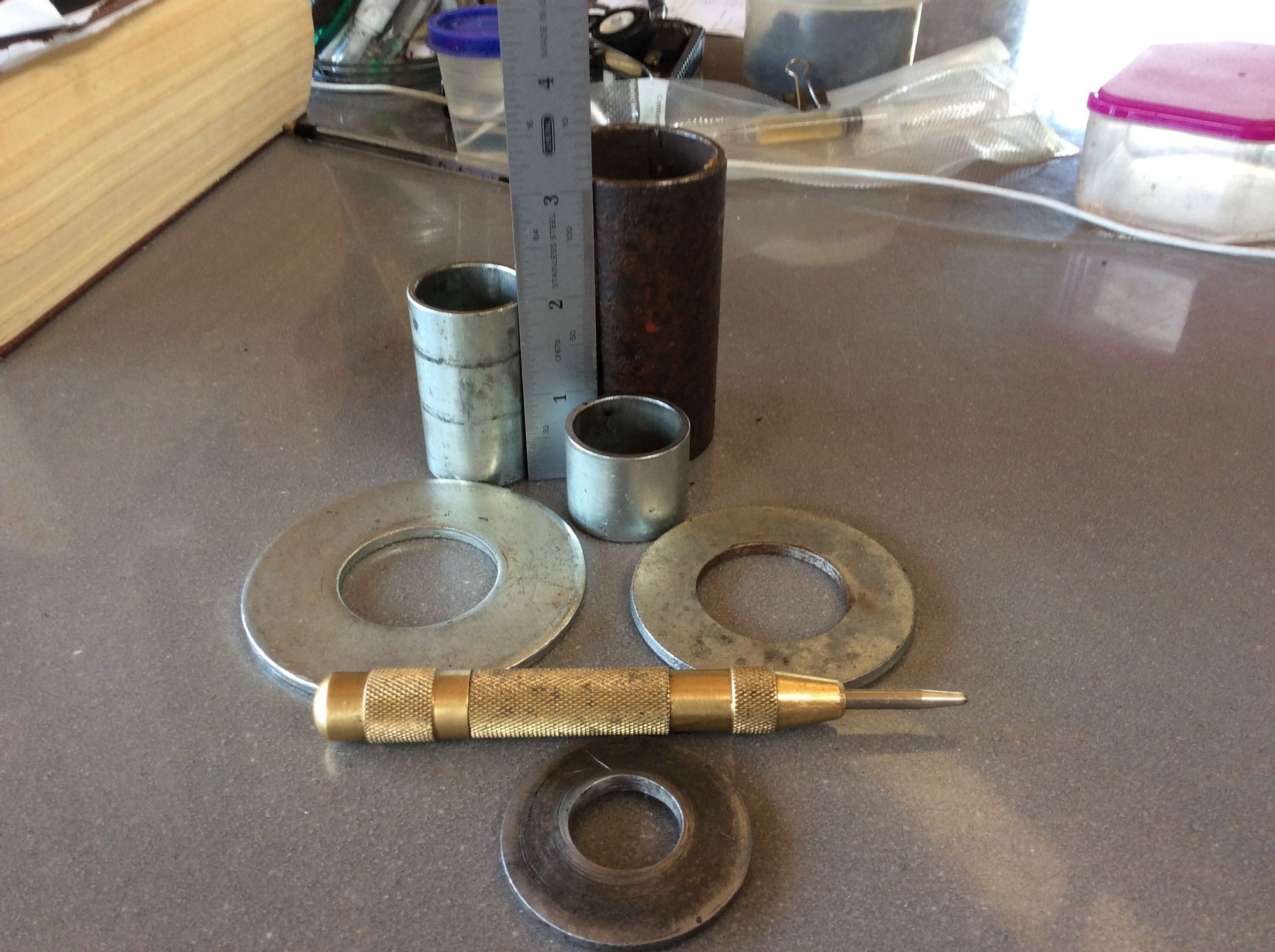

I discovered that the slight wobble in the left front wheel was because the axle was not properly engaged in the rear by the cv joint , also when the “mechanic” who had tried to jury rig it & not got things proper he had bent the armature plates & the axle nut was not tight enufe which had allowed the bearings to spin on the shaft. I determined where the center of that was & used a spring loaded punch (so all marks would be identical), to put 4 point marks on the shaft so the bearing required a slight press to go on. This also helps to keep the stuff in place on final assembly. Cut some pieces of pipe to desired length so axle could be pulled into place & axl bearing prior to whl installation, since some said that the armatures could be flush, used washers & pipe to press outer one back to flush, using tiny hammer to tap around on washer to (insure uniformity)(evenness), put Hilliard clutch Assy on,then pressing bearing into position, holding armature plate in position by HAND, put hub on, add bearing, washer/s & nut so cotter pin hole is central of the towers on the castle nut, torque to 110/120
INCH lbs !!!!!! To get the the electo magnets to work I had to clean the grounding area & wire ends, added silver contact lube that has a little oil in it, now all works great ! SEE ATTACHED photo , sorry I did not take assy pics.
Hope all this helps someone GOD BLESS, Happy new Year WWW.sonlifetv.com
If I were doing this prophesionally I would lath off the outside of the washer so it allowed the proper .001/.0015 clearance
