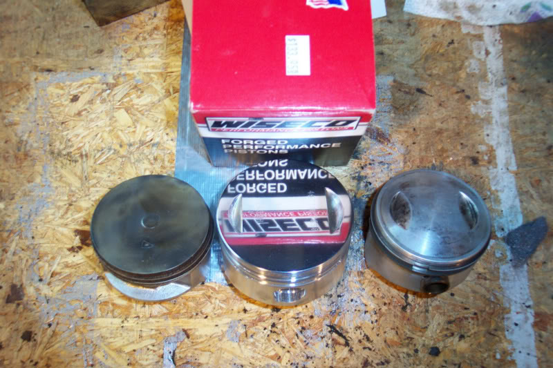

Photobucket finally got their site up again. The middle piston is the wiseco lakota. The one on the right is my 67.5mm 230 wiseco piston. On the left is the 66mm stock 250 4wd piston.

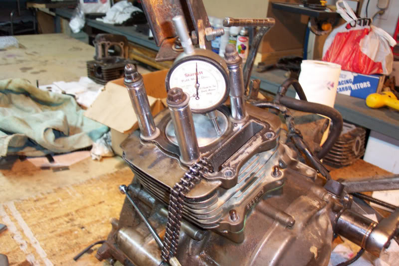

My apparatus to find the deck height. Apparently, wiseco already decked their pistons. At least mine is decked. .002 in front and .010 in back. Good enough.
So, I need a piece of aluminum .140 thick to make a spacer plate out of. The base gaskets are .020. Add them up for .160 or 4mm. I'm going to Lowes tomorrow, I'll see what kind of aluminum sheets they have.

Technically, its called zero decking the piston. It means the piston exactly level with the top of the jug (deck). And THAT means there is only the thickness of the gasket to keep the piston from smacking the head. I think .030 is a good gap to have, which is a popular size for head gaskets. As it turns out, the gasket I have is .030. The problem.... the 230 head doesn't have much flat surface to work with to get good quench. So, I'll have to mill on the head some to get a decent flat part to match up with the piston. Read about quench here: http://www.theoldone.com/archive/quench-area.htm

Pulled my engine out again, and popped the top. I'll bet it isn't a weisco piston. Your correct about them having mill marks. Looked at the 70mm (69 or whatever it is) looks like your polished one! The weiscos, 2 new one old, are just like you said, ready for tile. I'll have to call LA Sleeve this week to find out what they sent.

So, the 260 kit piston looks like my polished one? Is it flat on top too, or domed? Did somebody polish it for you, or does it come that way from wiseco???
