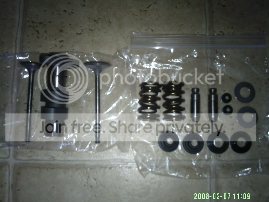

Here is around $280.00 well spent[img]i/expressions/face-icon-small-tongue.gif[/img] Stage two cam 213 grind. Performance valve spring kit, along with new valves and guides. Now to get all this to the machinist.

Looks good! Do you still have the stock cam, or did you have to send it in?

I sent it in and $70.00 is knocked off the core charge if they determine it's still usable.

What brand cam did you end up getting?

Webcam. They were very quick and in receiving processing and getting it back about a week total.
